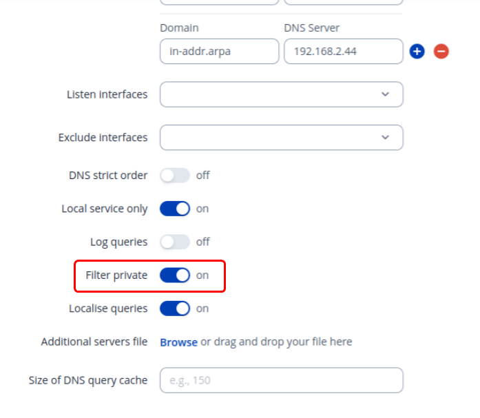

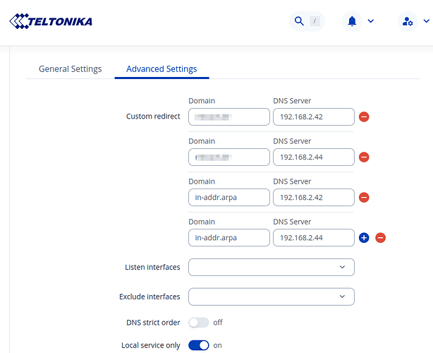

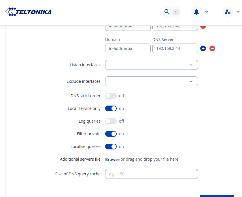

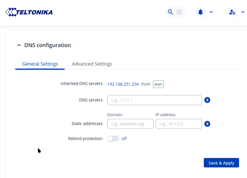

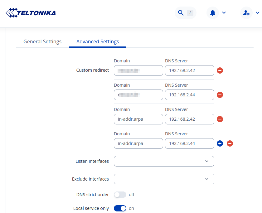

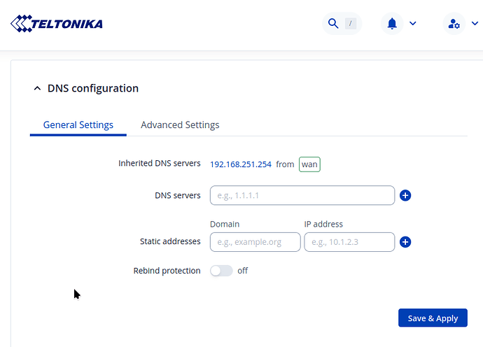

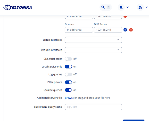

Sure. This is what I have configured:
The device has the address 172.22.11.1 on its br-lan interface. The following shell transcript is from a machine connected to br-lan:

I would expect your device to follow its configuration and forward the request for PTR-Record of 1.11.22.172.in-addr.arpa to 192.168.2.42 and 192.168.2.44 and to deliver whatever those forwarders did return.
