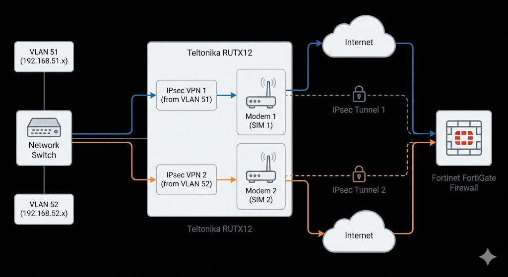

This is the schema. I can’t get the routes configured correctly

However, I don’t think this setup will meet my needs. The issue I’m facing is that both IPsec VPN connections point to the same IP address (Fortinet), so I have no way to apply Policy-Based Routing (PBR) effectively.
To resolve this, I would need the Teltonika to work in parallel (if that’s even possible), managing the routing specifically for each VLAN.
For example:
  • VLAN 51 should route exclusively via SIM 1, enter the VPN, and reach the firewall’s public IP.
  • VLAN 52 should route exclusively via SIM 2, enter the VPN, and reach the firewall’s public IP.
Policy-based routing is used to determine which WAN interface traffic exits the router through. Even though the IPsec tunnel points to the same IP address, this does not affect the routing decision, as the policy rules are created based on the LAN and WAN interfaces.
In this case, traffic originating from the 192.168.51.x network is routed through SIM 1 (MOBILEWAN1), while traffic from the 192.168.52.x network is routed through SIM 2 (MOBILEWAN2).
