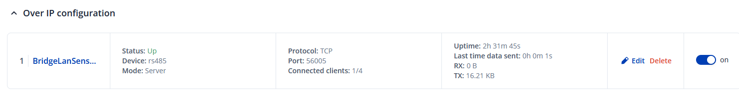

I defined a Serial Utilities - OverIP configuration on a port to the 485 port.
Once enabled and queued by a tool I see the TX field incremented but no responses:
If i send the same command by ‘Modbus Serial Client’ page + ‘Test’ I have response.
