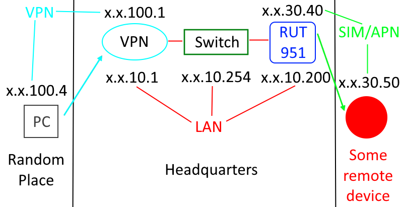

I’m trying to figure out a connection through VPN which grants access to a LAN network, this network has a RUT951 with a SIM card which grants access to remote devices via APN.
Here is a draft of what I’m trying to achieve:

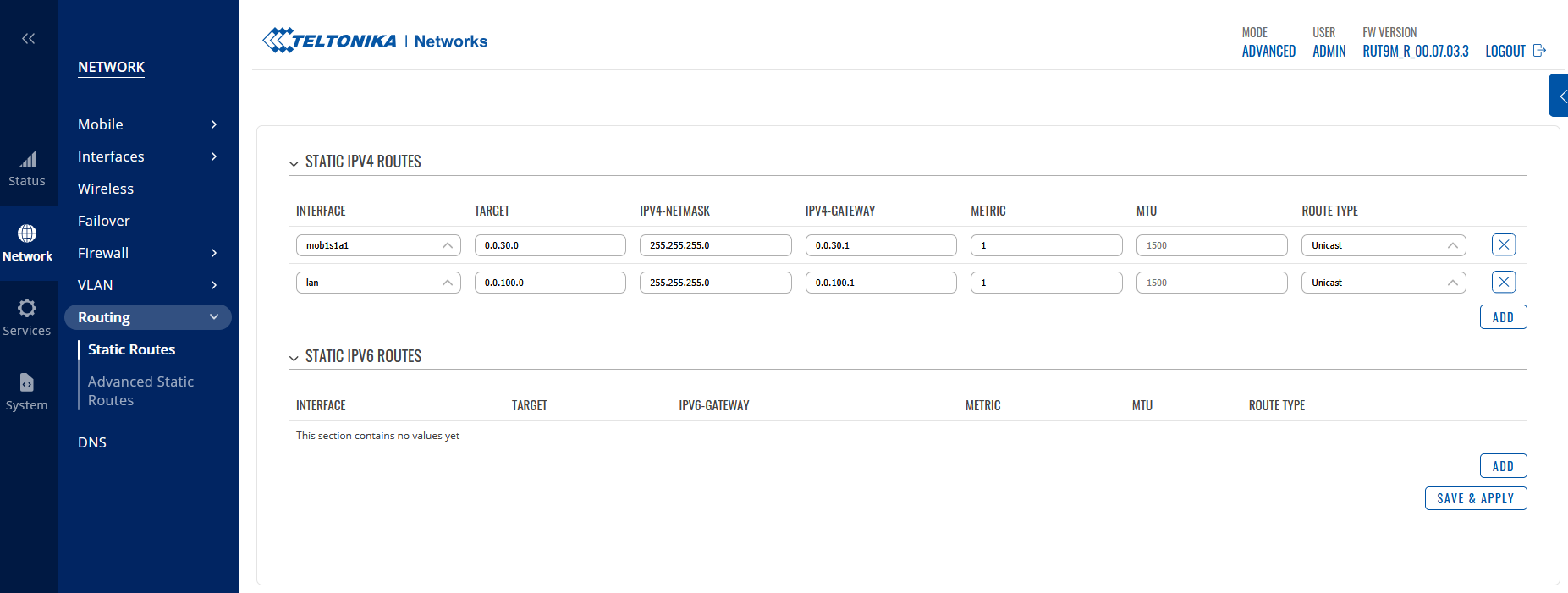

I did create a route to get access to the RUT951 from the VPN:

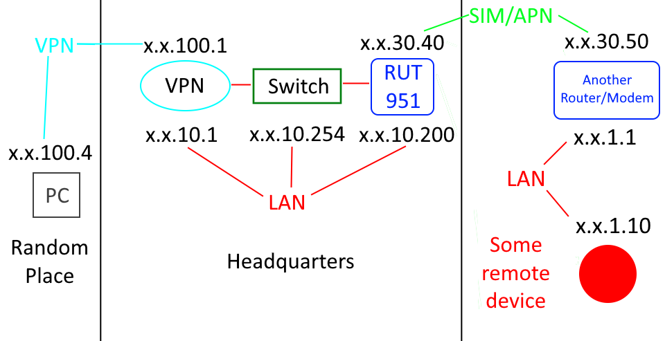

I will explain here the configured IP’s of the diverse devices involved:
PC:
IP VPN: x.x.100.4
VPN:
IP VPN: x.x.100.1
IP LAN: x.x.10.1
Switch:
IP LAN: x.x.10.254
GW: x.x.10.1
RUT951
IP LAN: x.x.10.20
IP WAN (APN): x.x.30.40
GW: none
Router/Modem:
IP WAN (APN): x.x.30.50
IP LAN: x.x.1.1
GW: none
Remote Device:
IP LAN: x.x.1.10
GW: x.x.1.1
Yes, It is a private fixed IP (x.x.30.40) from the APN/SIM card. The other router/modem also have a private fixed IP (x.x.30.50).
Both are configured with a standard NAT setup. Here is a better draft:

Based on your described network layout, I’d suggest trying the following by adding static routes on both the RUT951 and the “another router/modem”:
  • On RUT951 (to reach the remote device’s LAN):
    • Interface: mob1s1a1 (or wan)
    • Target: X.X.1.0/24
    • Gateway: X.X.30.50
  • On the “another router/modem” (to reach RUT951’s LAN):
    • Target: X.X.10.0/24
    • Gateway: X.X.30.40
Please give this a try and let me know if it works.
