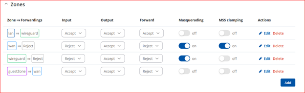

Firewall settings AFTER following the guide to set up the guest zone:
At this point I have no internet connection when logging into the guest_wifi. I think my problem is not configuring the firewall correctly.

It looks like this may well be your firewall settings. These are very much down to your individual usecase(s) and how you’ve chosen to deal with isolation.
You could try, the below to see if it gets you started and then work up / down your paricular needs from there.
For your lan zone > inter-zone forwardings …
Allow forward to destination zones = wan, wireguard, guestZone
Allow forward from source zones = wireguard
For your wireguard zone > inter-zone forwardings …
Allow forward to destination zones = lan
Allow forward from source zones = lan
For your guestZone zone > inter-zone forwardings …
As I said, you have to config your firewall to YOUR specification. The above settings for instance would allow the lan to intiatiate traffic to your guestZone but the guestZone cannot initiate trafic to your lan zone - if your default policies are set to Forward = Reject.
Add/Delete/Amend as required by your needs.
