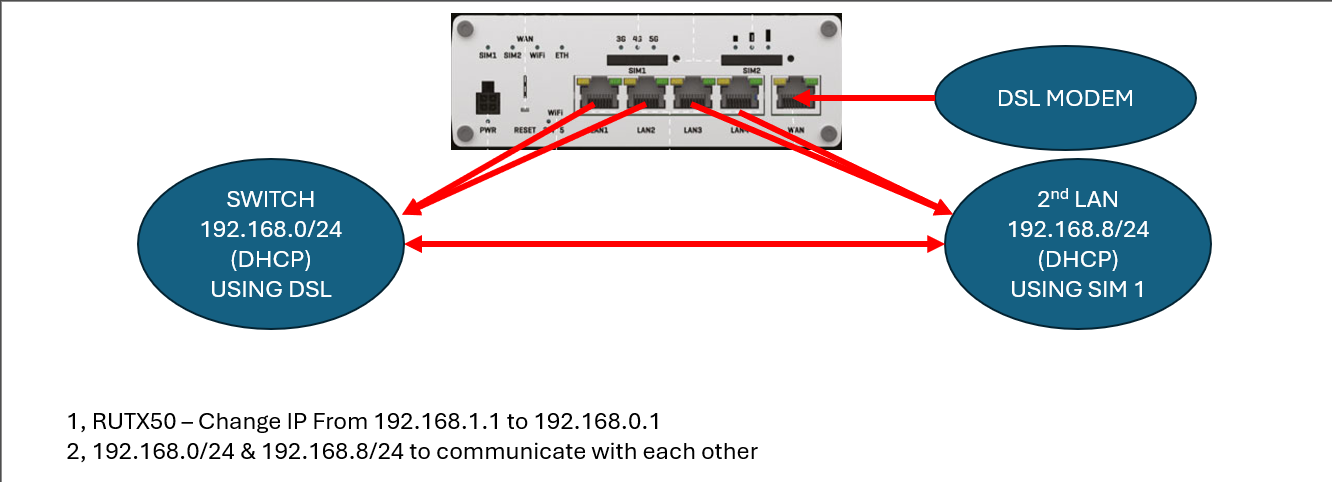

Happy to PAY! to configure "simple" RUTX50 requirement
4 Days is enough… I have tried every guide, everything I can find relevant with google, everything I find is for a different Teltonika device / does not work for me.
I have been successful with a very similar config using VM’s running PFSense, Sophos XG Firewall, but wanted a device like this to replace an ageing power consuming hp server.
I cannot understand why I cannot make this work as previously mentioned I have got my head around PFSense & Sophos but anything I do on this RUTX50 just fails. I have factory reset 50+ times over 4 days and cannot get everything to work. I got close with the LANS working but both LANS insisted on using the SIM Modem no matter what I did.
I am happy to pay for someone’s time/donate to charity to either write a guide for the RUTX50 or login remotely to resolve the issue for me.
Many thanks

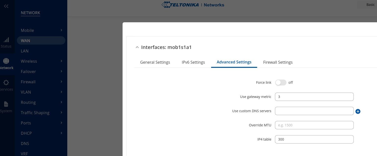

I think you need to separate WAN and mobile connections to different routing tables, because default route choose lowest metric one.

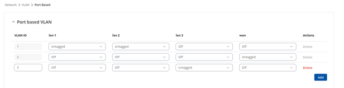

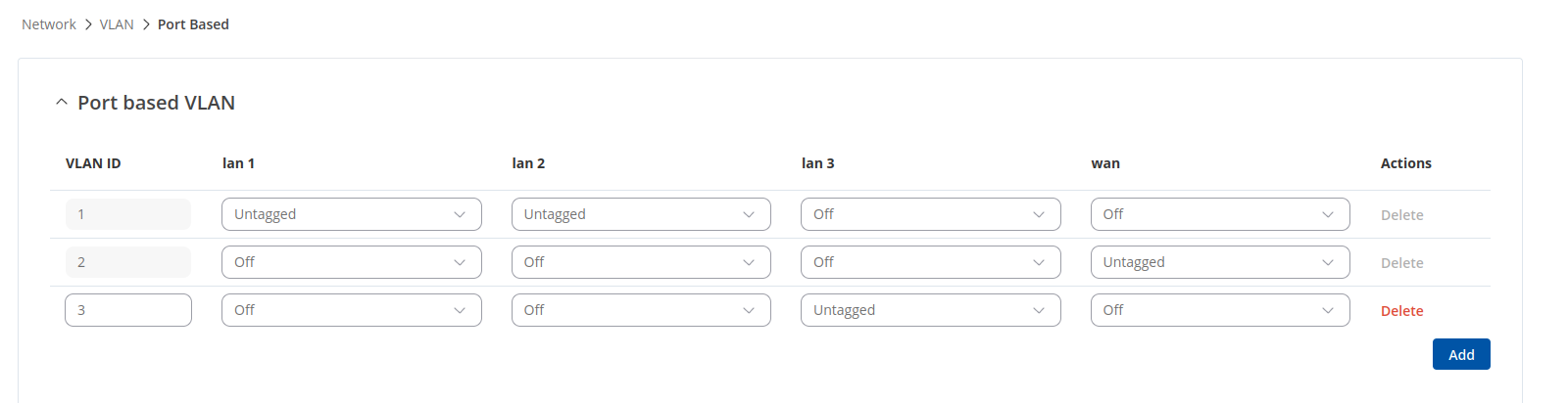

Then add VLAN for port separation:

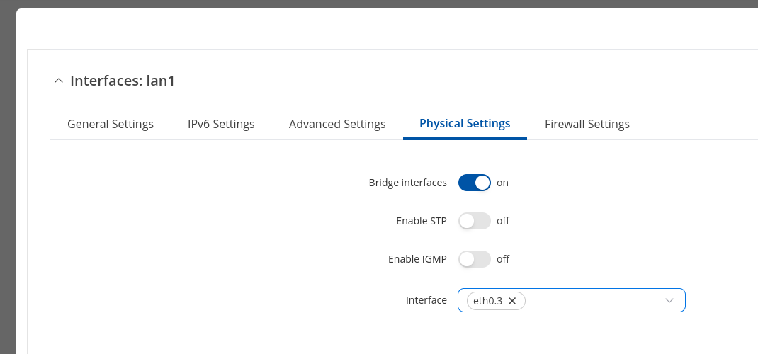

Create new LAN network with ports assigned:

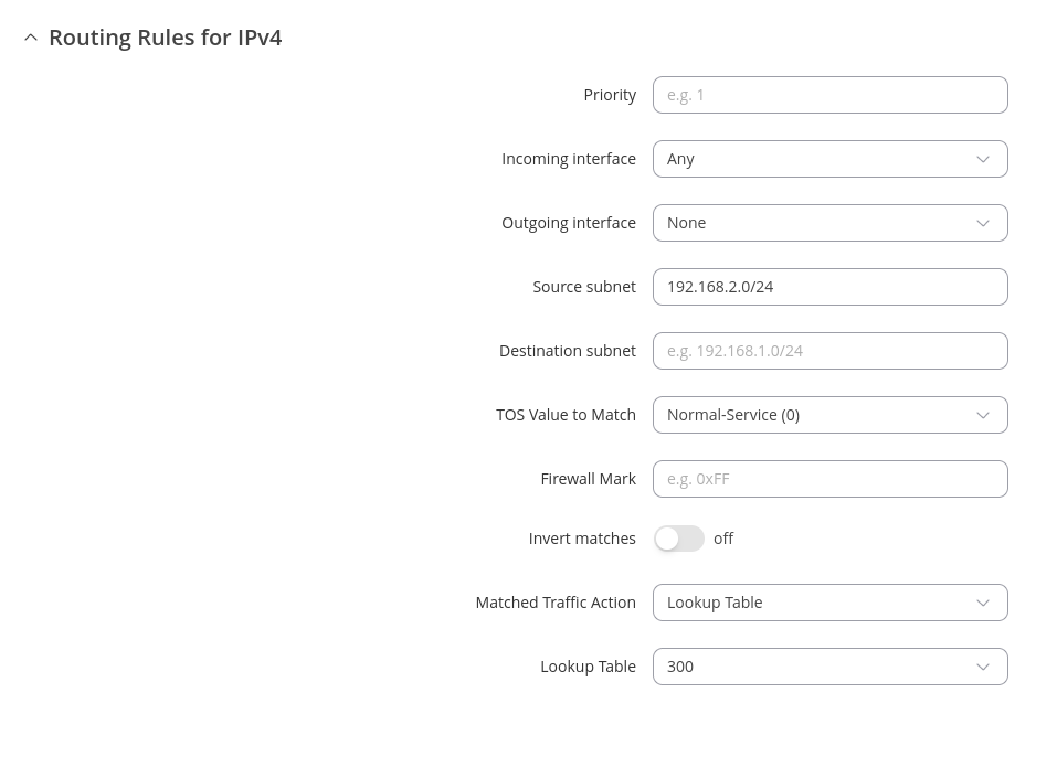

Add new routing rule to use new routing table:
And port 3 should go out through SIM1 :slight_smile:
