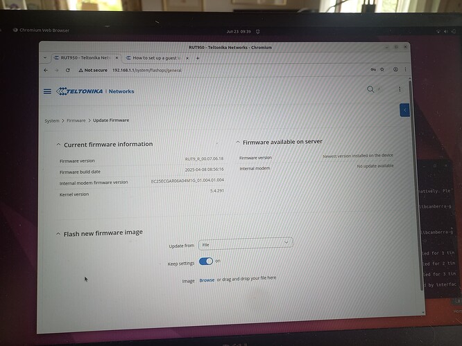

Additionally, please let me know the firmware version your RUT950 is currently running.

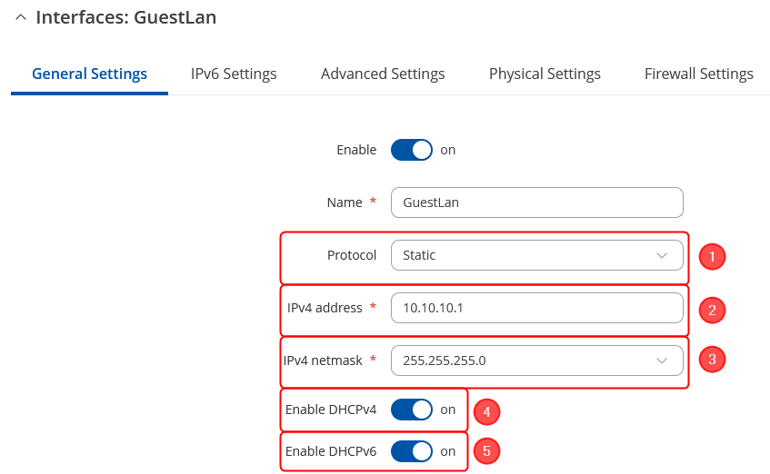

Just a reminder — you can find instructions on how to set up a guest Wi-Fi network on our wiki page here: How to set up a guest WiFi network - Teltonika Networks Wiki

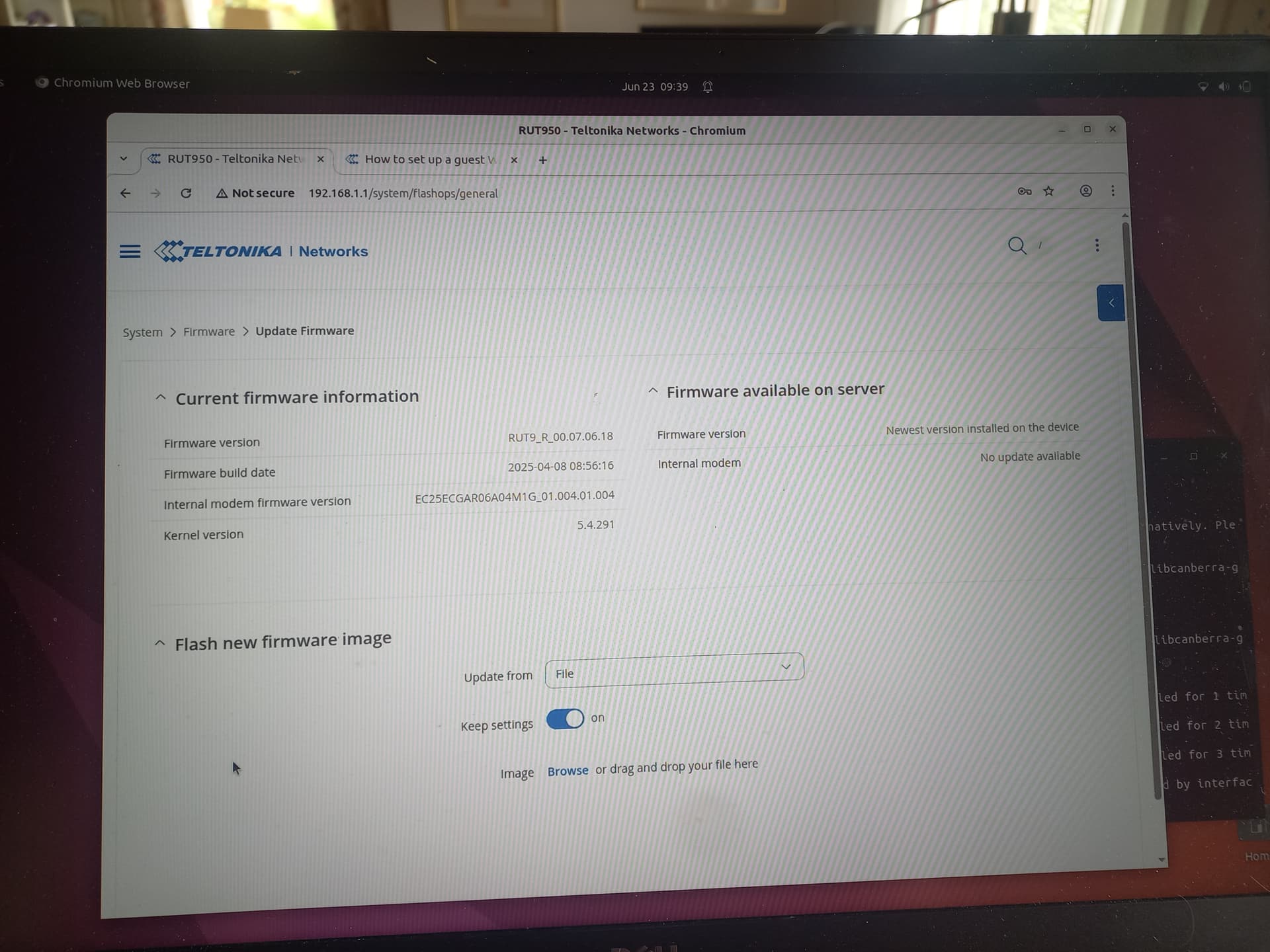

First a picture showing my firmware version:

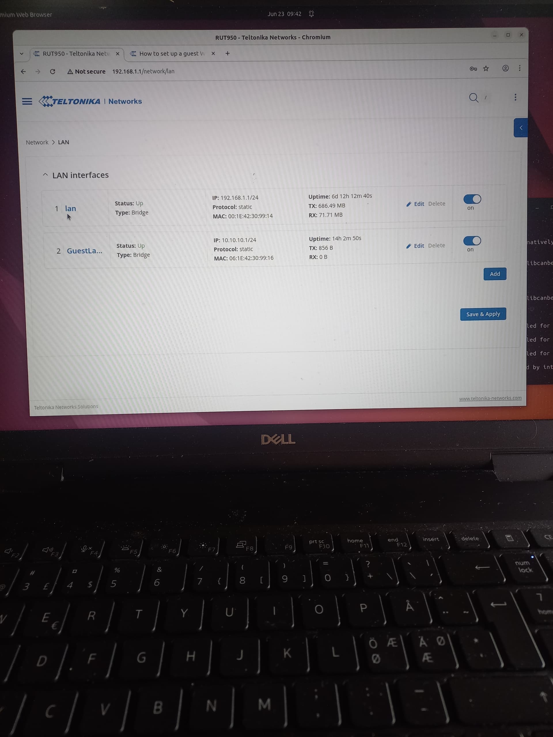

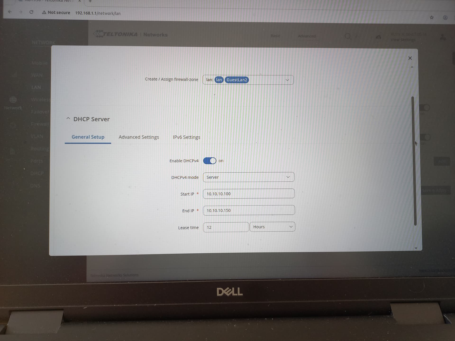

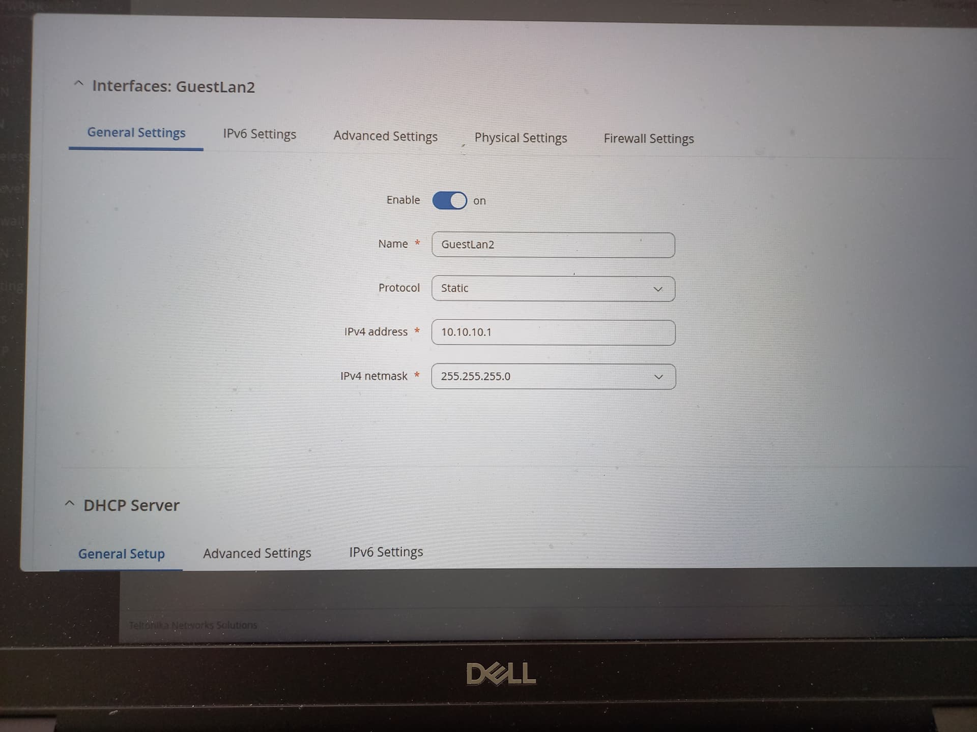

Then the two LANs I have configured:

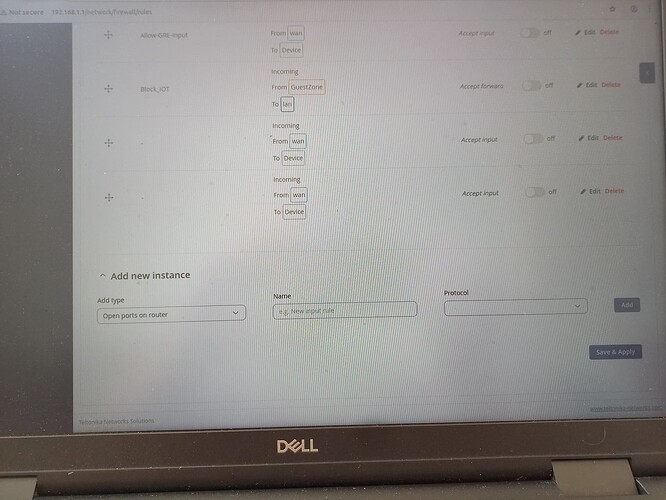

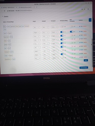

And my guestzone:

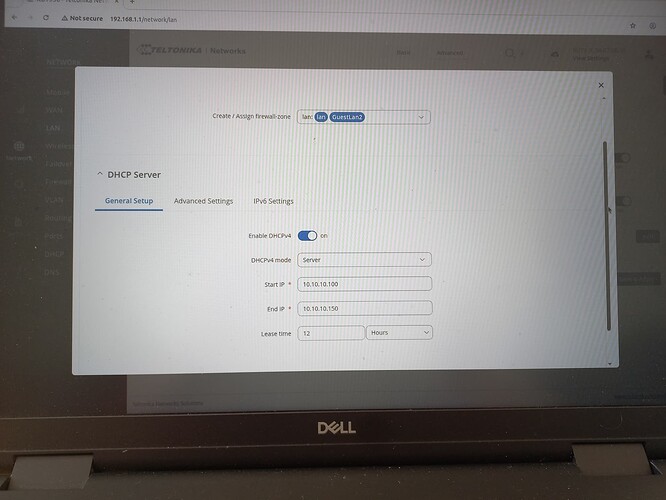

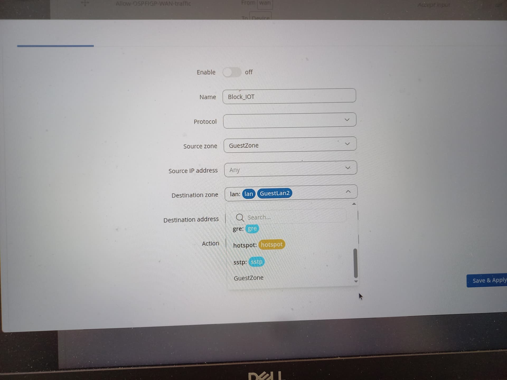

When I am trying to block guest from the router I am unable to select guestzone and guestlan2. I either get lan and guestlan2 or guestzone:
I have tried to follow the instructiona exactely. My web interface does not seem to be exactely the same as in the instructions.

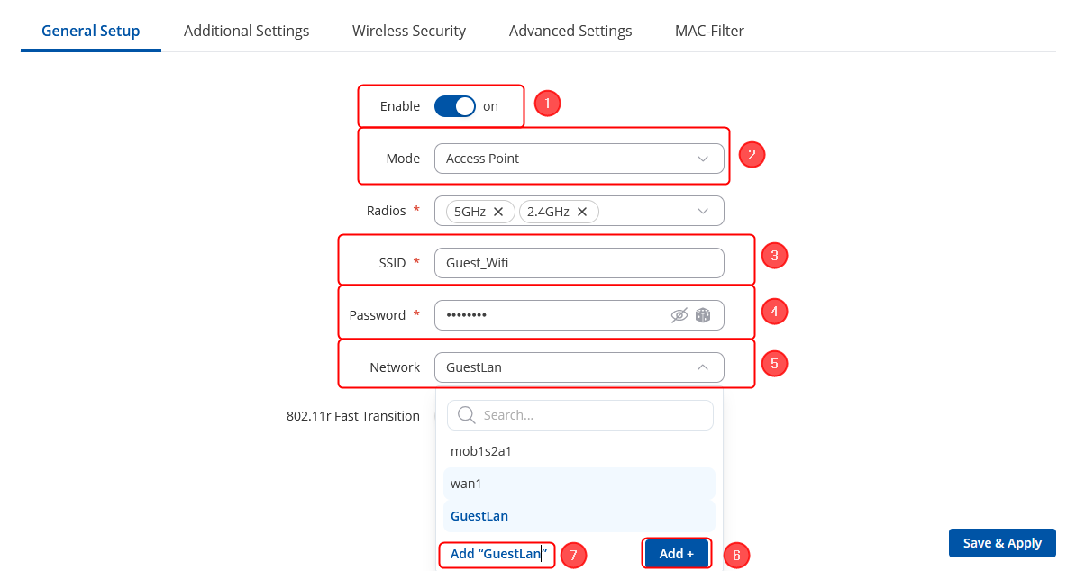

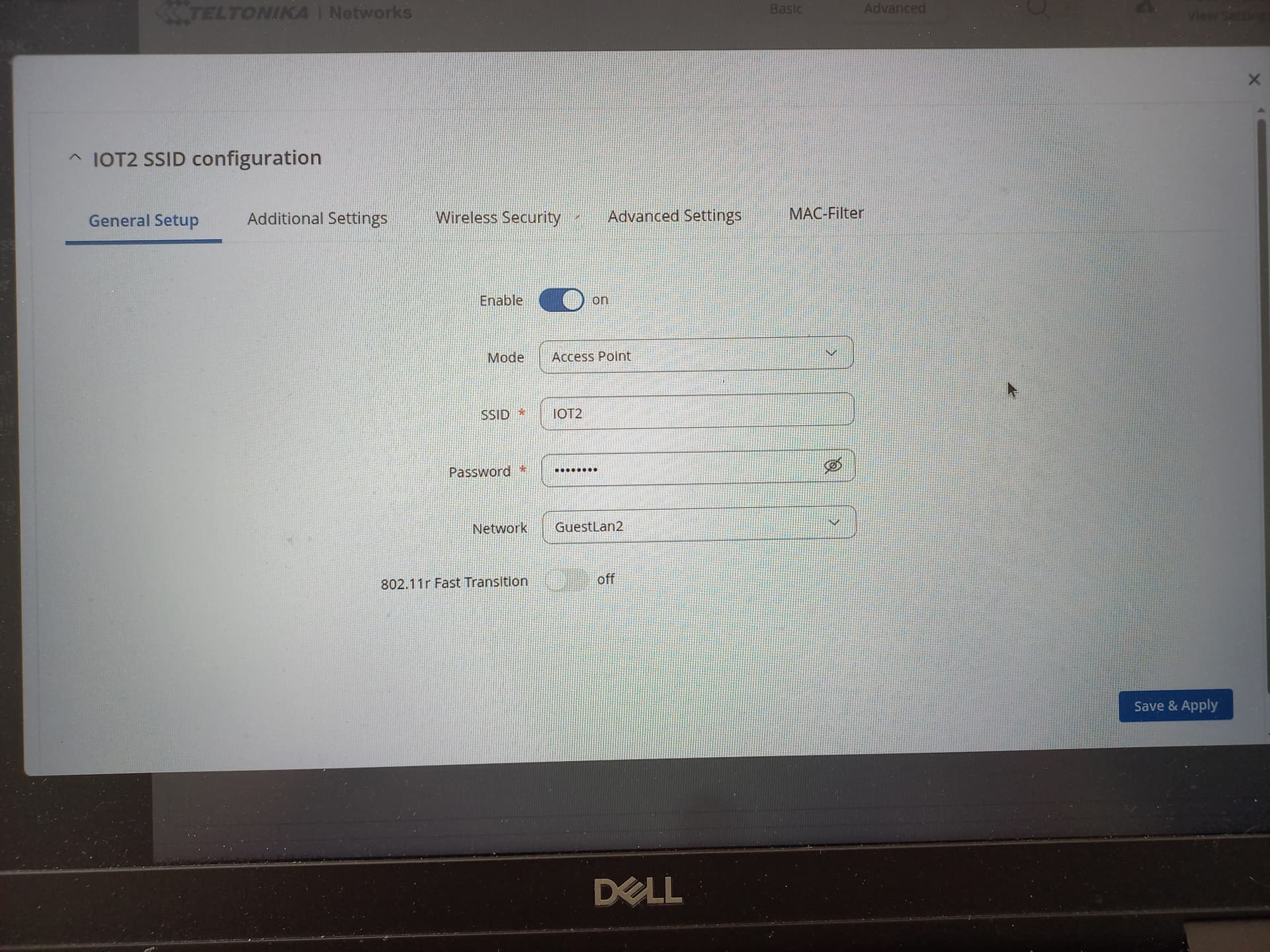

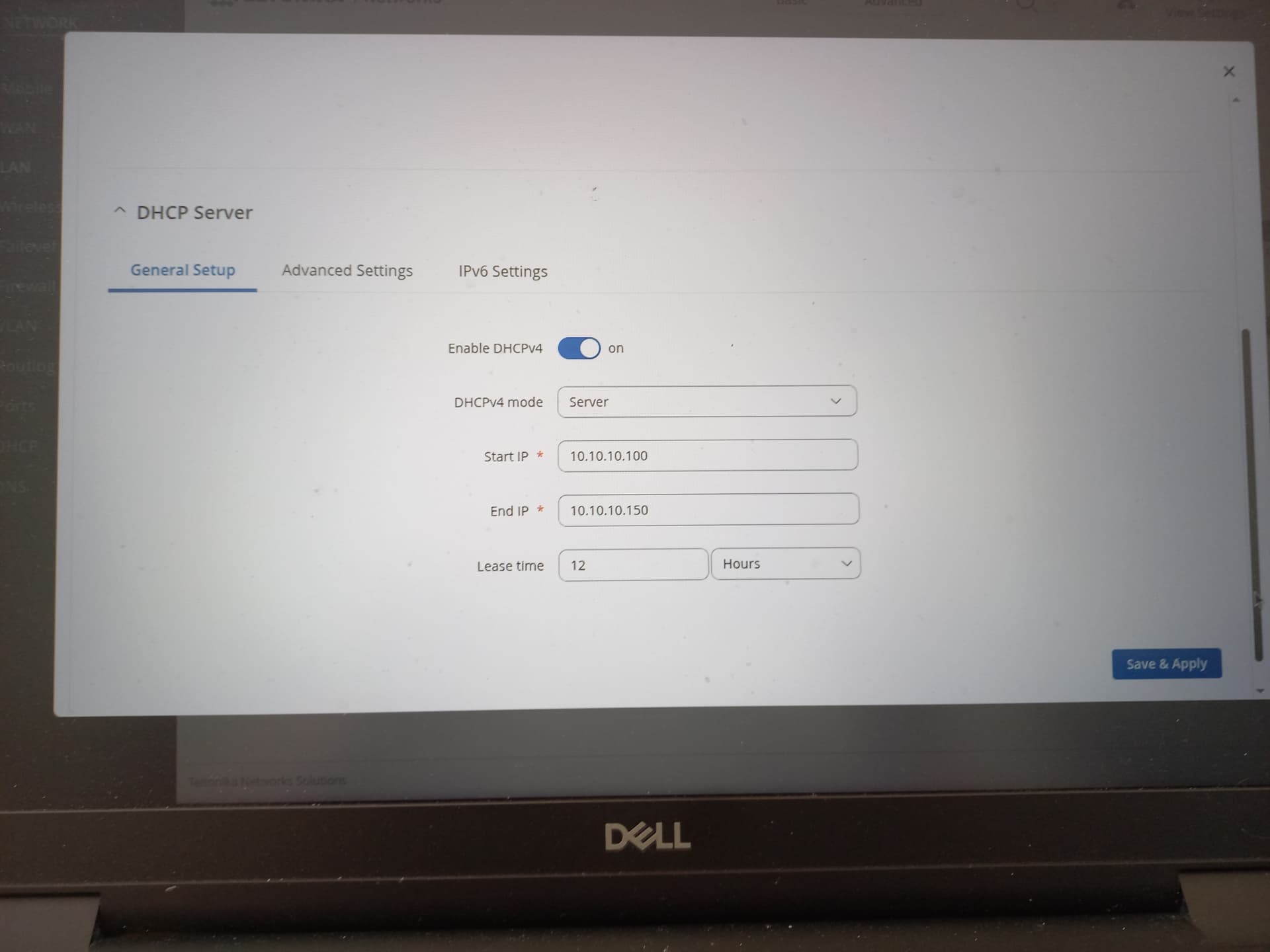

Could you please share screenshots of your configuration from the following sections?

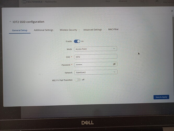

Wireless:

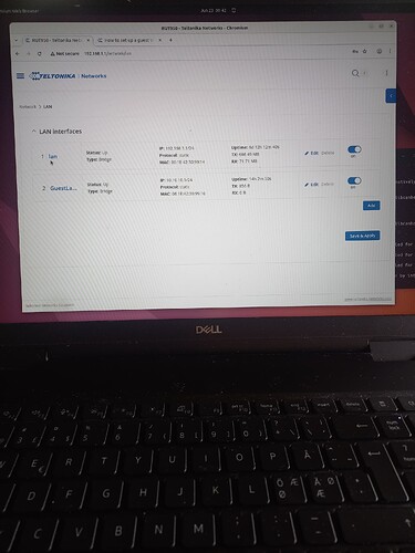

LAN:

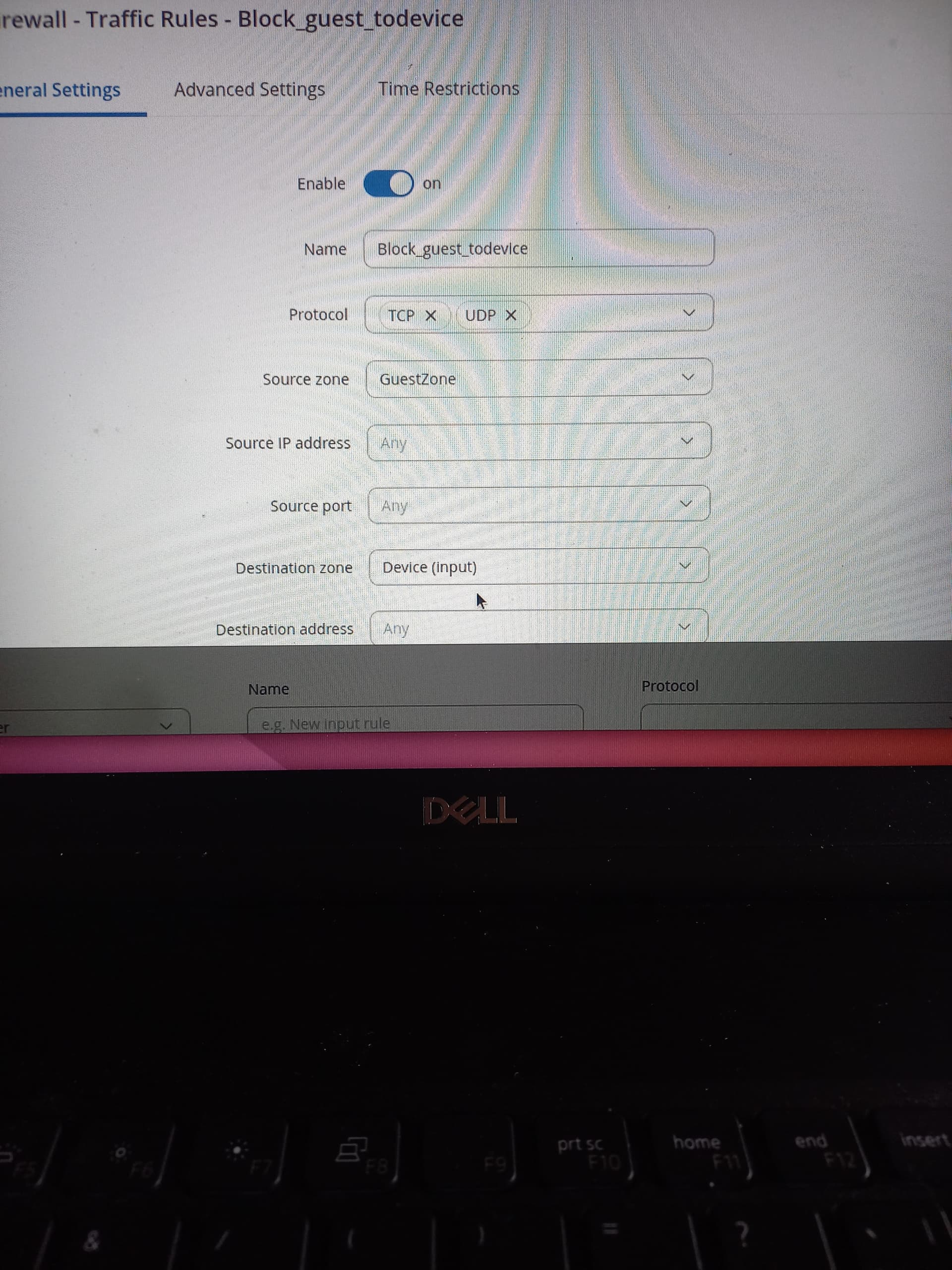

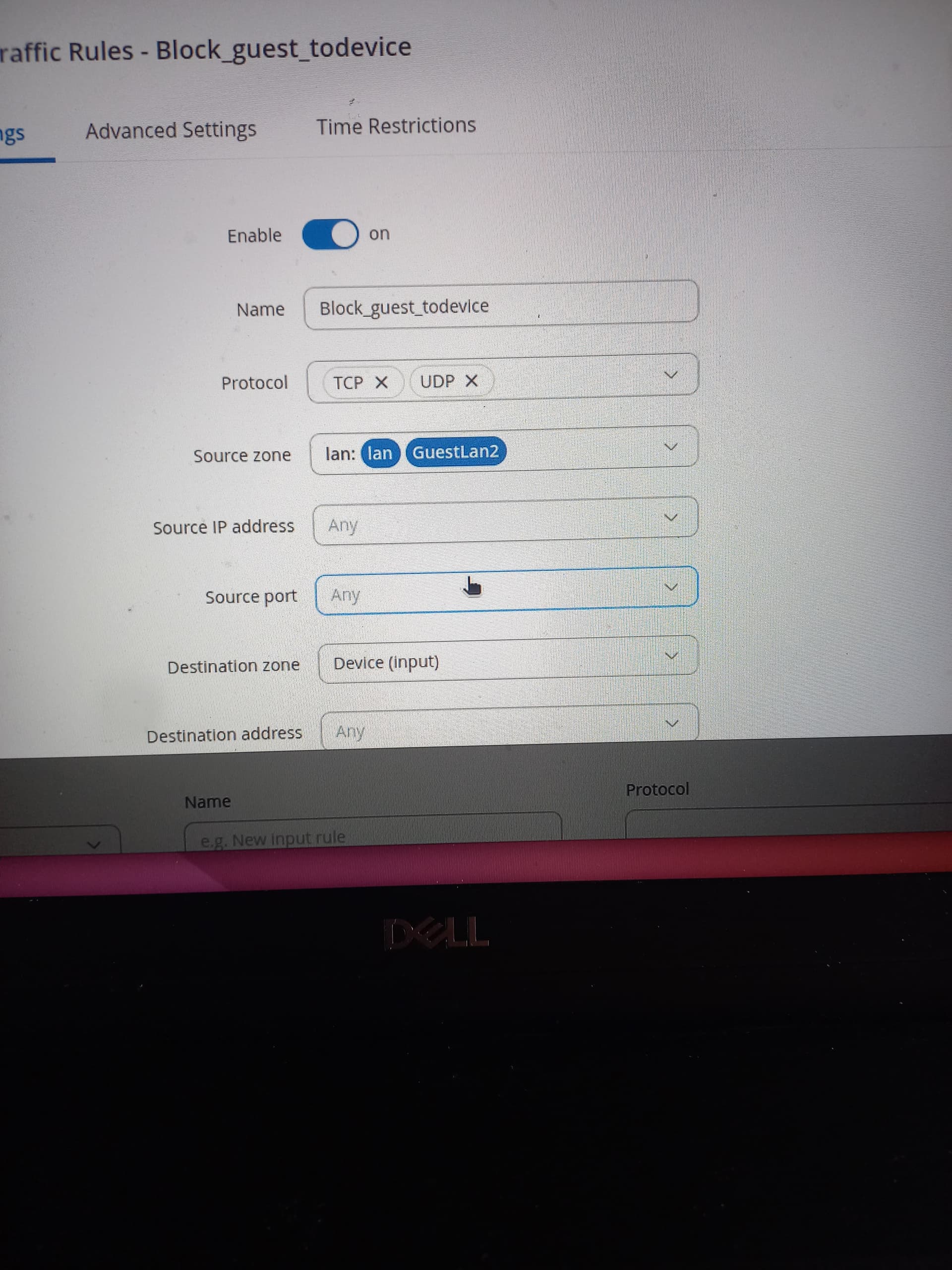

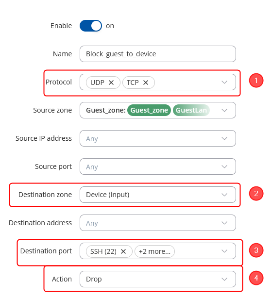

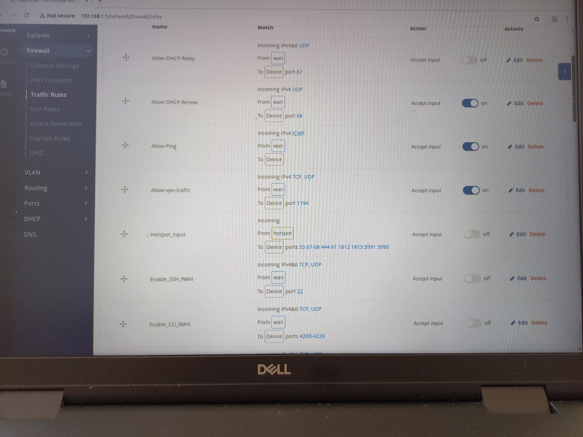

In the Traffic Rules section, I noticed that under Source zone, you have Guestlan2 and lan selected. However, it should be Guest_zone and GuestLan:
Additionally, please provide a screenshot of the Traffic Rules configuration where the destination ports and action are visible.

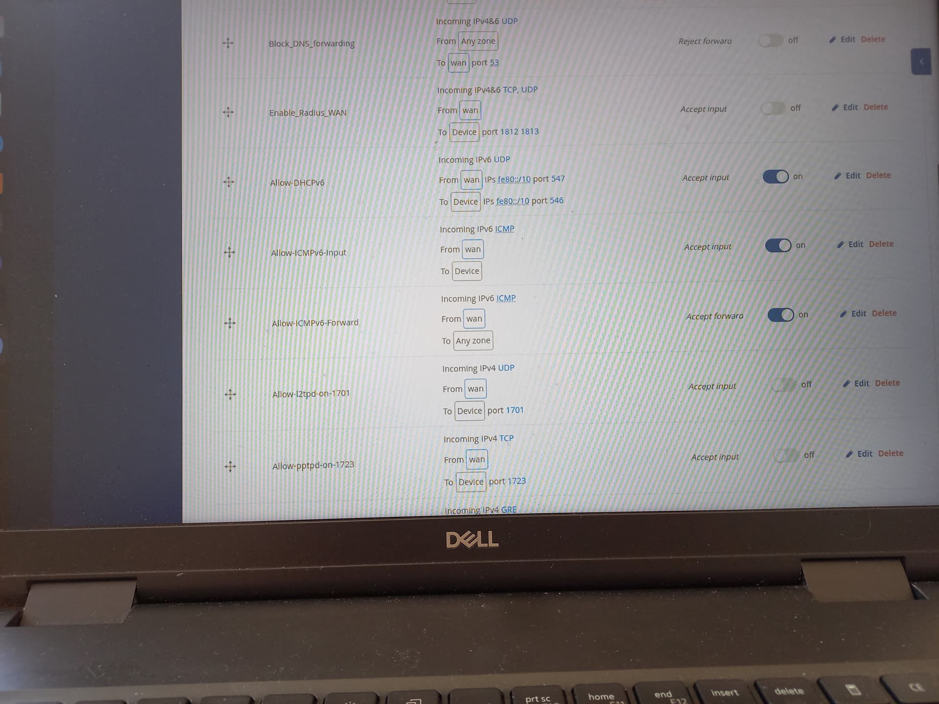

Below are my screenshost. My guestlan is called GuestLan2 simply because I tried so many times and wanted to be sure to start fresh. You noticed “you have Guestlan2 and lan” selected however it should be Guest-zone and GuestLan". The answer is that I am not presented with any alternative that has a zone and lan.

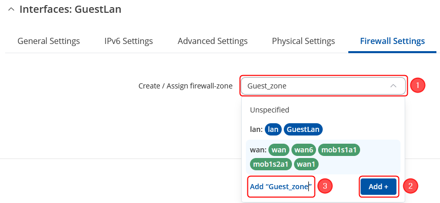

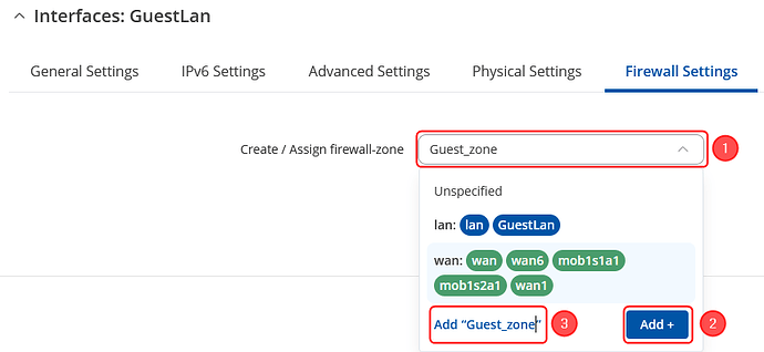

In the LAN Firewall Settings configuration for GuestLan2, next to Create / Assign firewall-zone, create a new zone by clicking the Add New button. Enter a name for the zone (e.g., Guest_Zone) and then click the Add+ button.
After adding the zone, please follow the instructions provided here: How to set up a guest WiFi network – Firewall rules.
