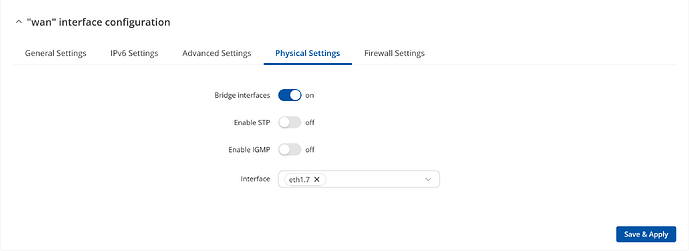

I had a hard time getting the “Glasfasermodem 2” running for German Telekom with a Rutx50. So I just want to make it easyier for you to get it running with a Teltonika Router.

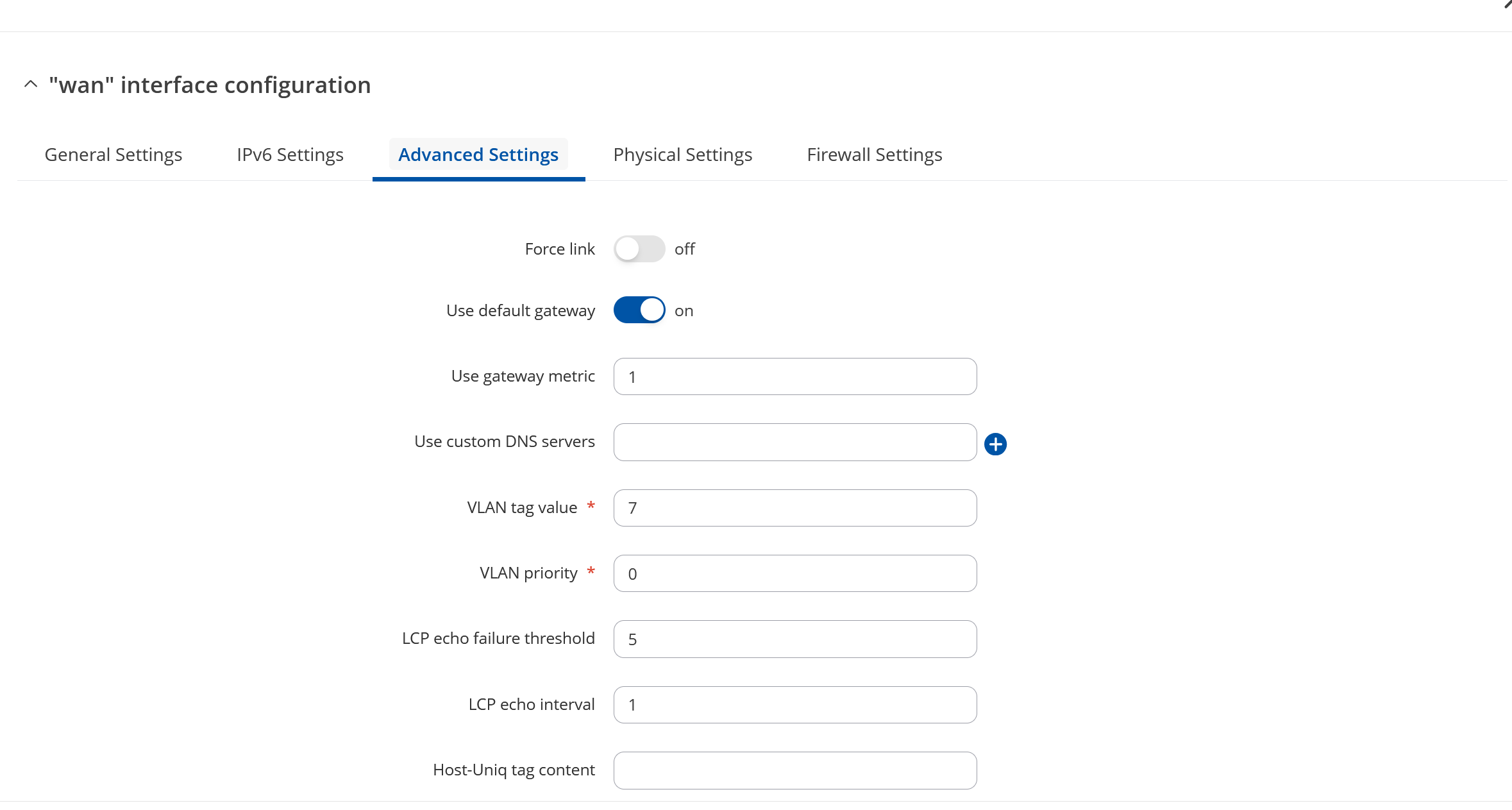

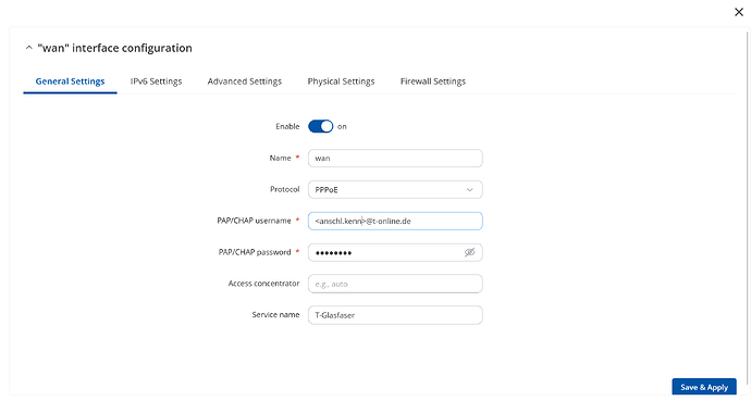

  1. configure wan interface PPPoE

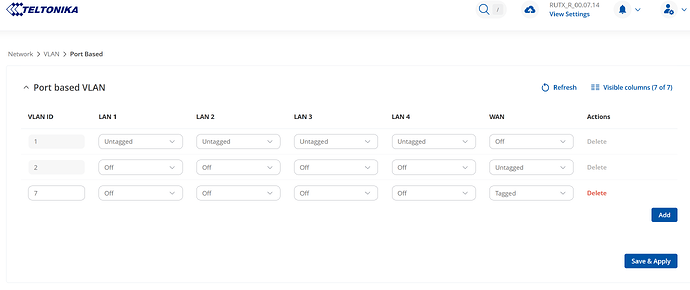

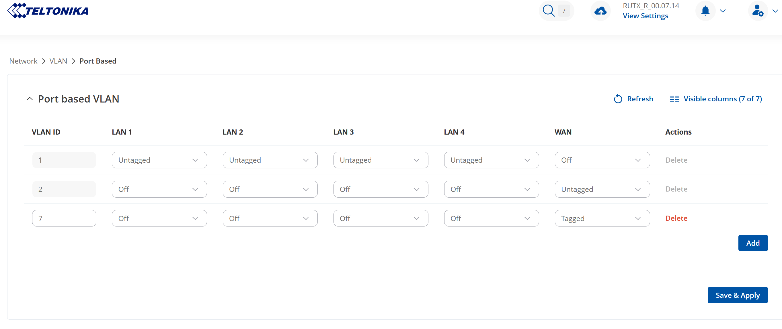

  2. set up interface to use tagged VLAN 7 where the modem is attached to

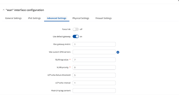

  3. go back wlan/advanced and set VLAN 7 and VLAN priority 0

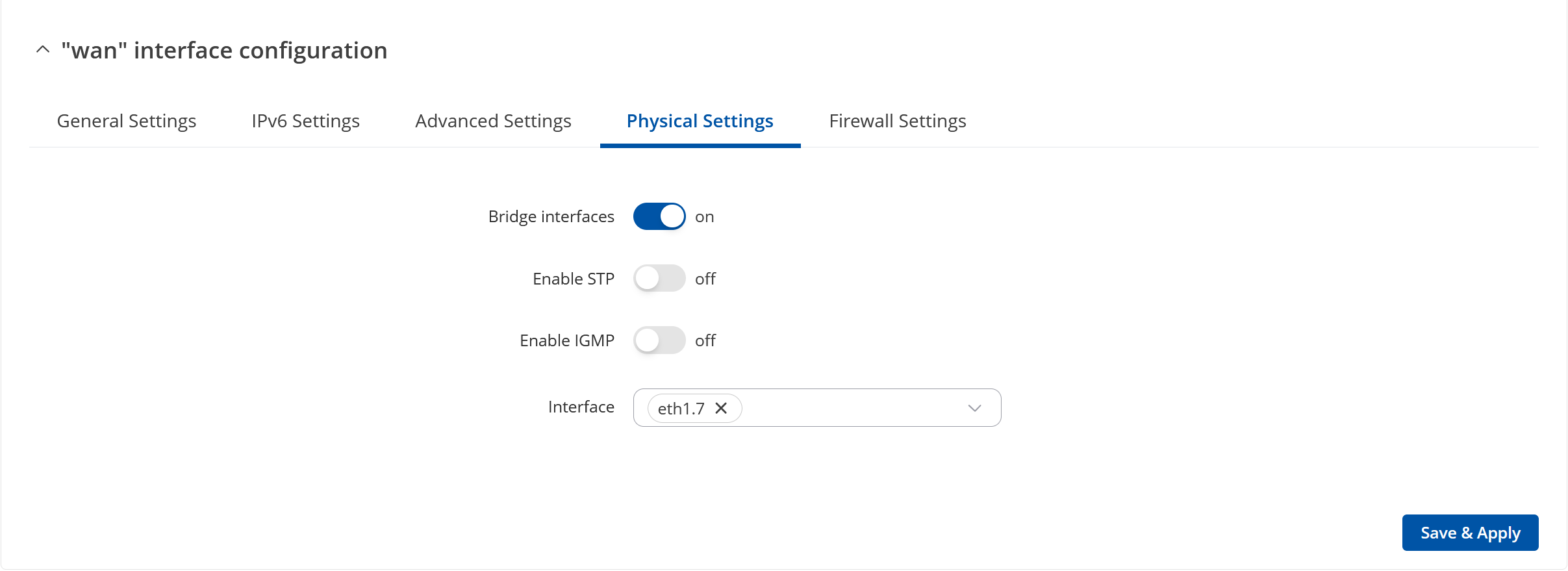

  4. tell wan interface to use the ethernetport with the tagged interface
    done!
