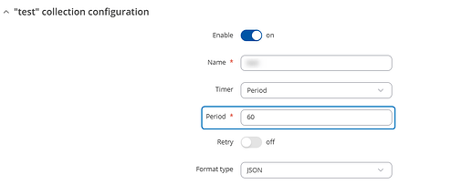

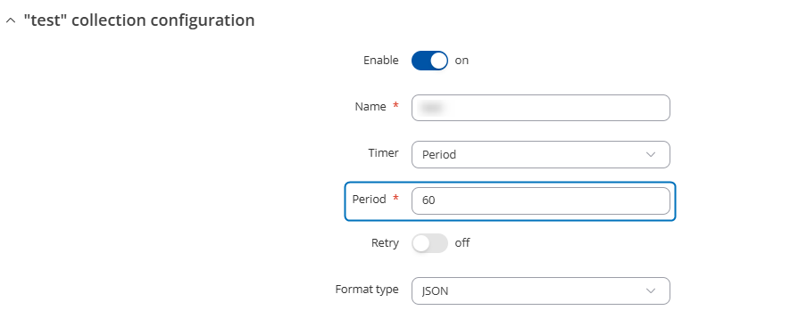

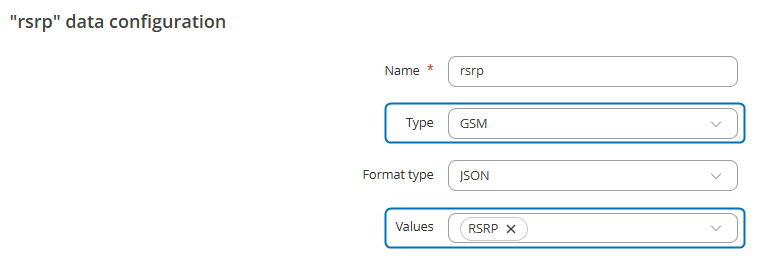

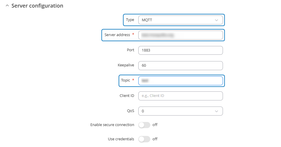

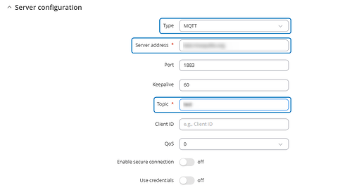

Unfortunately, RSRP values can’t be read from the Modbus registers. However, the simplest alternative to achieve this would be to use the Data to Server feature configured for the GSM data type, with RSRP selected under the Values section. You can then set this data to be sent to your MQTT broker every 60 seconds.
