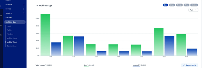

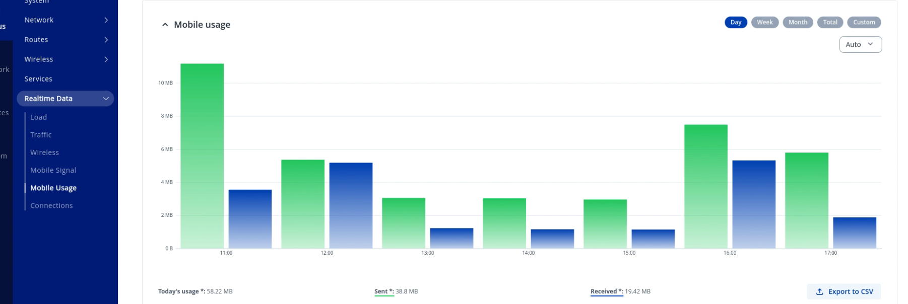

I intend to make a shell script for this task. However, getting data usage from /sys/class/net/wwan0/statistics/tx_bytes and /sys/class/net/wwan0/statistics/rx_bytes is incorrect.
It does not match data used in Data limit or realtime data/mobile usage as picture below.
where can I get the correct data usage?

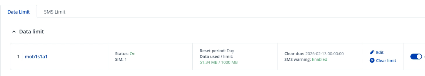

  • From your screenshots, I can see that the limit reset period is set to “day.” Can the limit exceed 2 GB more than once per day?

The data limit feature does match my goal

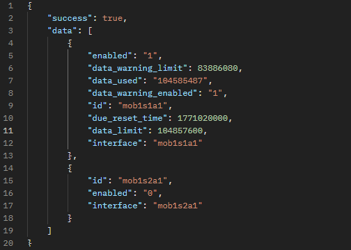

To retrieve the data usage information, you can utilize the API. Once a data limit is configured, you can obtain both the limit and the amount of data used via the following API endpoint:
/api/data_limit/status
The output should look similar to the example shown below.
Please note that both the data limit and the usage values are displayed in bytes.
You can find more details in our API documentation here:
https://developers.teltonika-networks.com/reference/rutx11/7.20.3/v1.12.1/data-limit#get-data_limit-status
