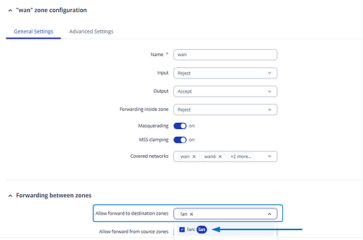

If I understood your setup correctly, you are trying to access an FTP server located on the RUT’s LAN from the WAN side, correct?
If that’s the case, you’ll need to ensure that traffic forwarding from the WAN zone to the LAN zone is allowed. This can be done by editing the WAN zone settings under Network → Firewall → Zones and enabling forwarding to LAN (refer to screenshot below).
That should generally be sufficient for FTP access to work.
If the inquiry or end goal of your setup differs, could you please clarify it and provide any relevant additional information, such as your network topology, configuration details, etc.?
