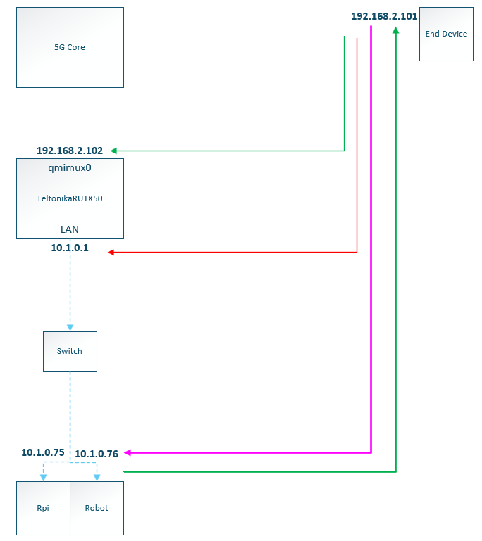

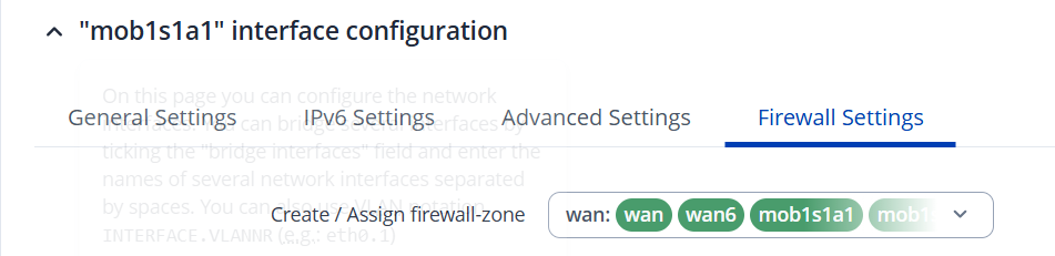

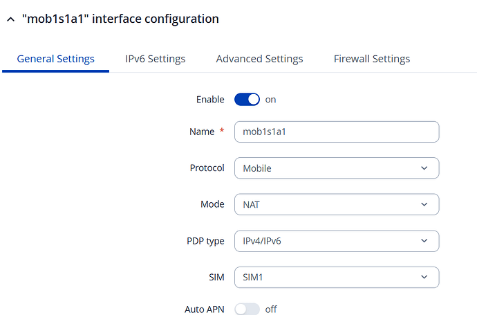

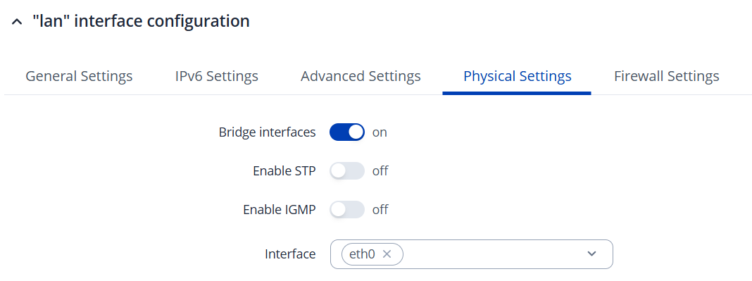

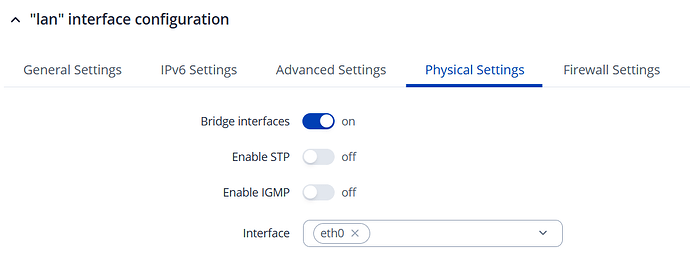

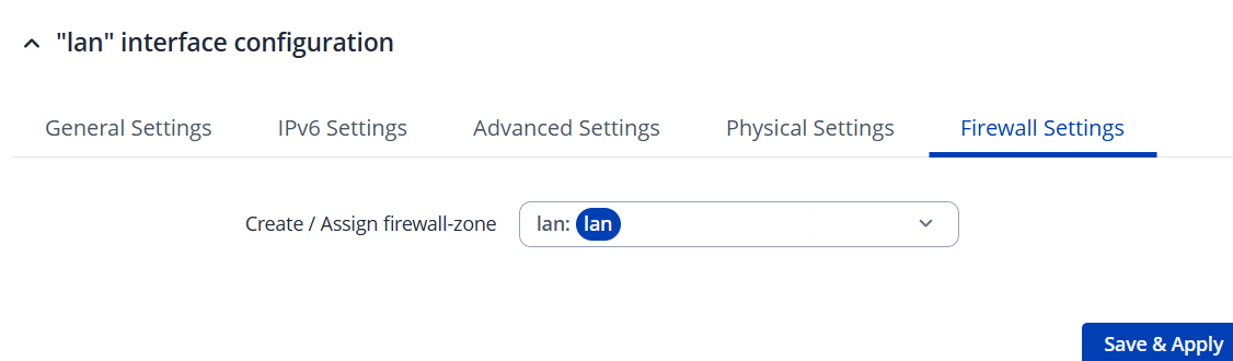

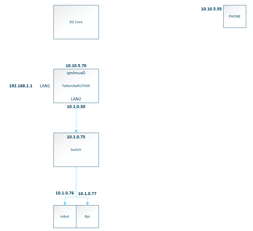

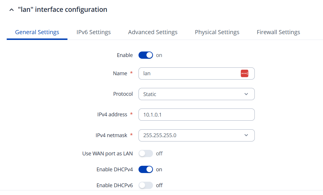

Hi I want to be able to reach the Rpi/robot from the phone, but the routing is not successful yet. I added a lan called portlan2 and it says ”Network device is down
Interface is starting or ethernet cable is not detected as plugged in. Check if port LEDs are lit.” I cannot even ping the 10.1.0.75…Given that lan1 is eth0 I set as eth1 the lan2, after having disactivated eth1 as interface of wan interfaces… the routing that i create for lan2 are seen as routing for lan1… can you please tell me why I am not even able to ping between to devices connected via utp cable which are rutx50 and switch? in order for the pinging and tranfer of data between mobile and lan, only the zones need to be configurated or do i need to do some further configuration?

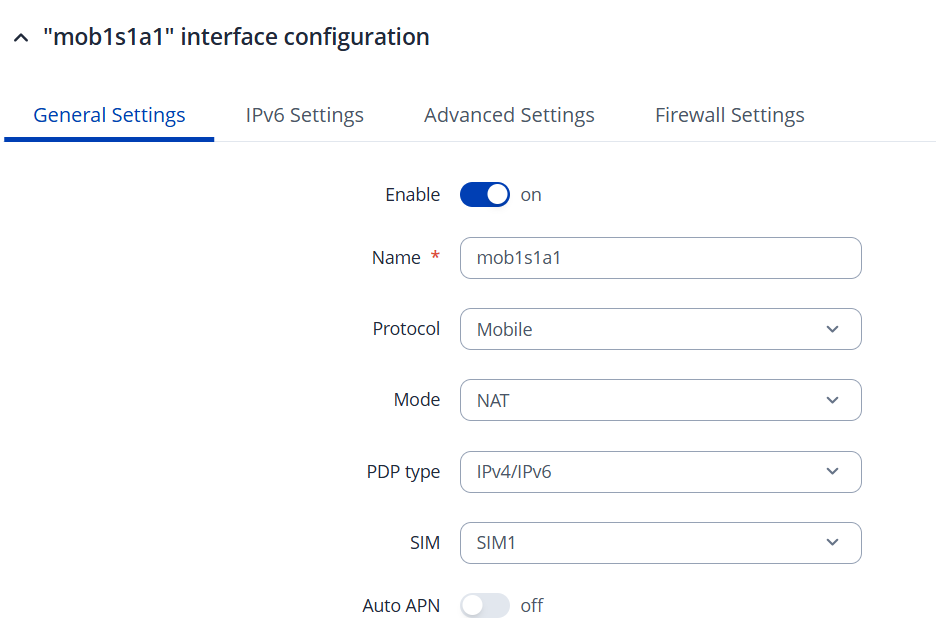

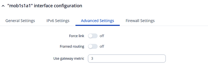

  2. Could you please send me screenshots of the current configuration? (LAN interfaces, VLAN settings, routes, and such)

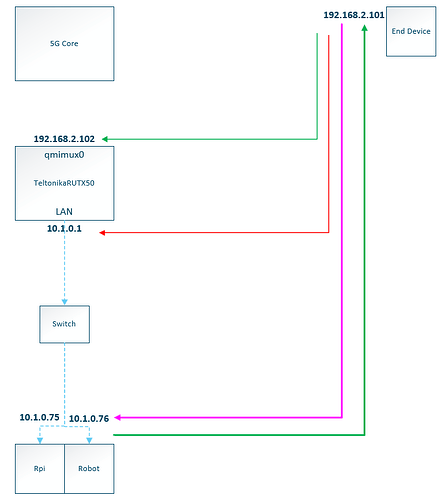

in the drawing you can see which pings are possible and which NOT:
  • Green successful PING
  • Red unsuccessful PING
  • Pink Desired PING
