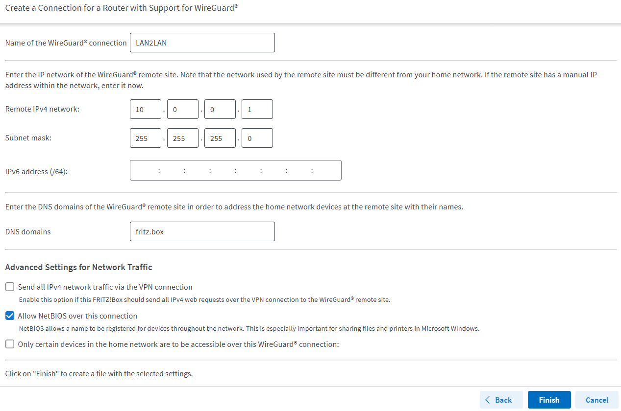

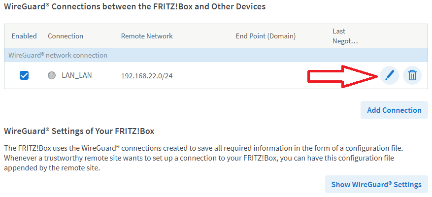

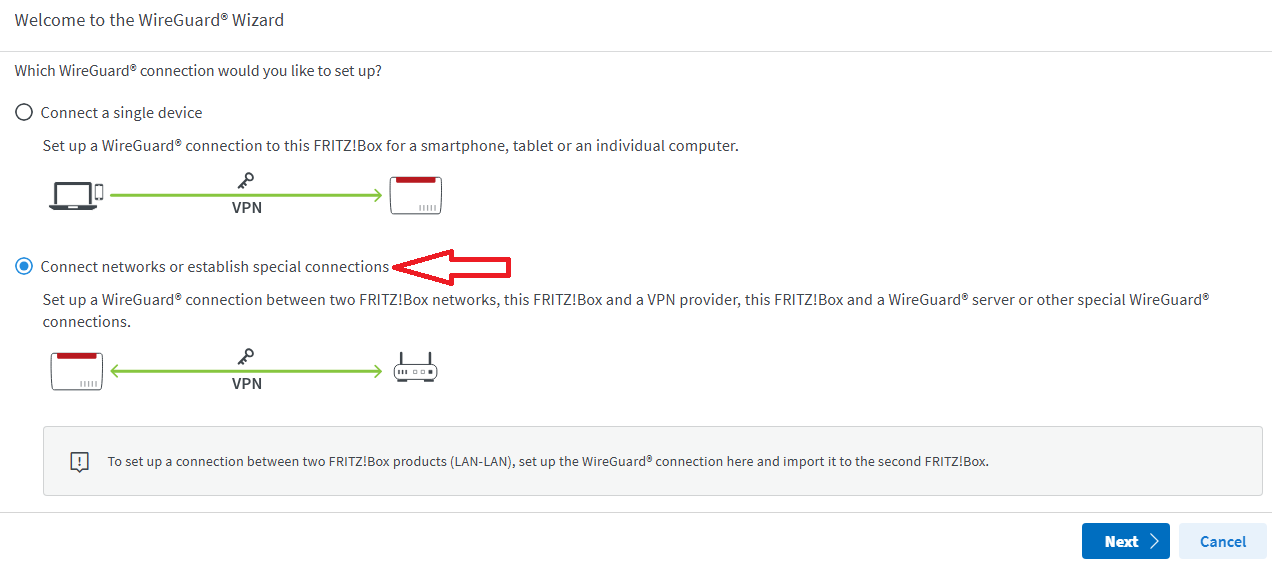

I have already created Lan to Lan connection in WireGuard settings in FritzBox 7590 (If needed I can recreate the whole things again):
When I click here
I get this settings:

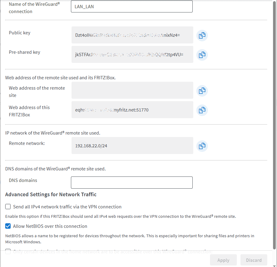

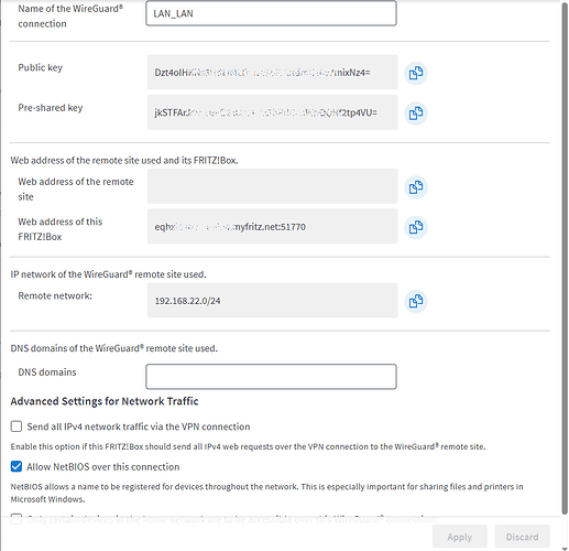

And when I click here

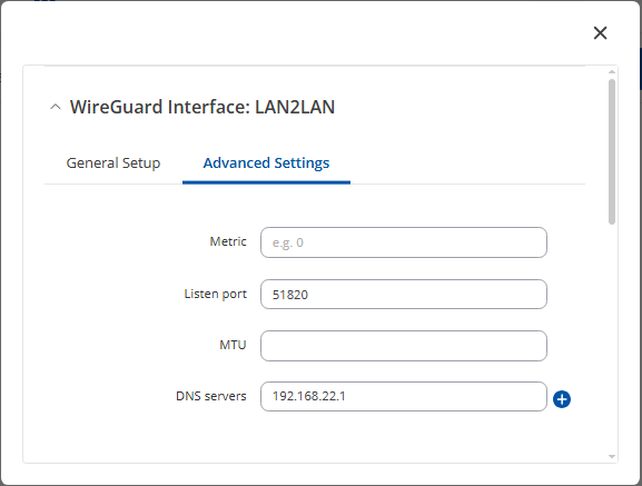

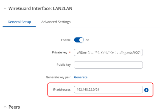

Here is RUT956 WireGuard settings:
Thank you!

In your FritzBox configuration, I can see that you have your FritzBox LAN IP set instead of the WireGuard server IP:
This is an older screenshot I’ve made for a different client, but in your case, it says 192.168.1.2 here, which I don’t believe is correct.
Next, this IPv4 section is for the WireGuard interface IP, not the LAN subnet:
This IP can be pretty much anything, for example, 172.16.10.1/24 or even /32, doesn’t matter.
Next, the peers list:
You have added yourself to the peers list, instead of the FritzBox (peer device), which you are trying to reach.
Please double-check these settings and make sure they’re correct as per the instructions.
Thank you very much MatasR for your help! I have applied your corrections to my settings, but it didn’t help. I’m quite sure that the problem lies in the FritzBox area, so I decided to start all over again. Could you review these settings, so we could move over?
I hope I have understood your corrections about FritzBox’s Wireguard settings.
