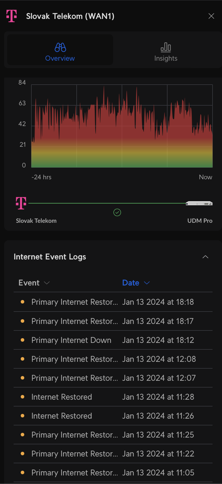

Hi. Eversince I switched to Teltonika TRB500 and using 5G/LTE with Slovak Telekom (Slovakia best 5G provider) I’m facing very frequent disconnect messages from Ubiquiti Dream machine Pro (Unify DMP). (See screenshots)

Now I’m using Teltonika TRB500 - with latest firmware, but even with regular updates I never had stable connection, and Unify DMP frequently sends notifications about WAN disconnects.

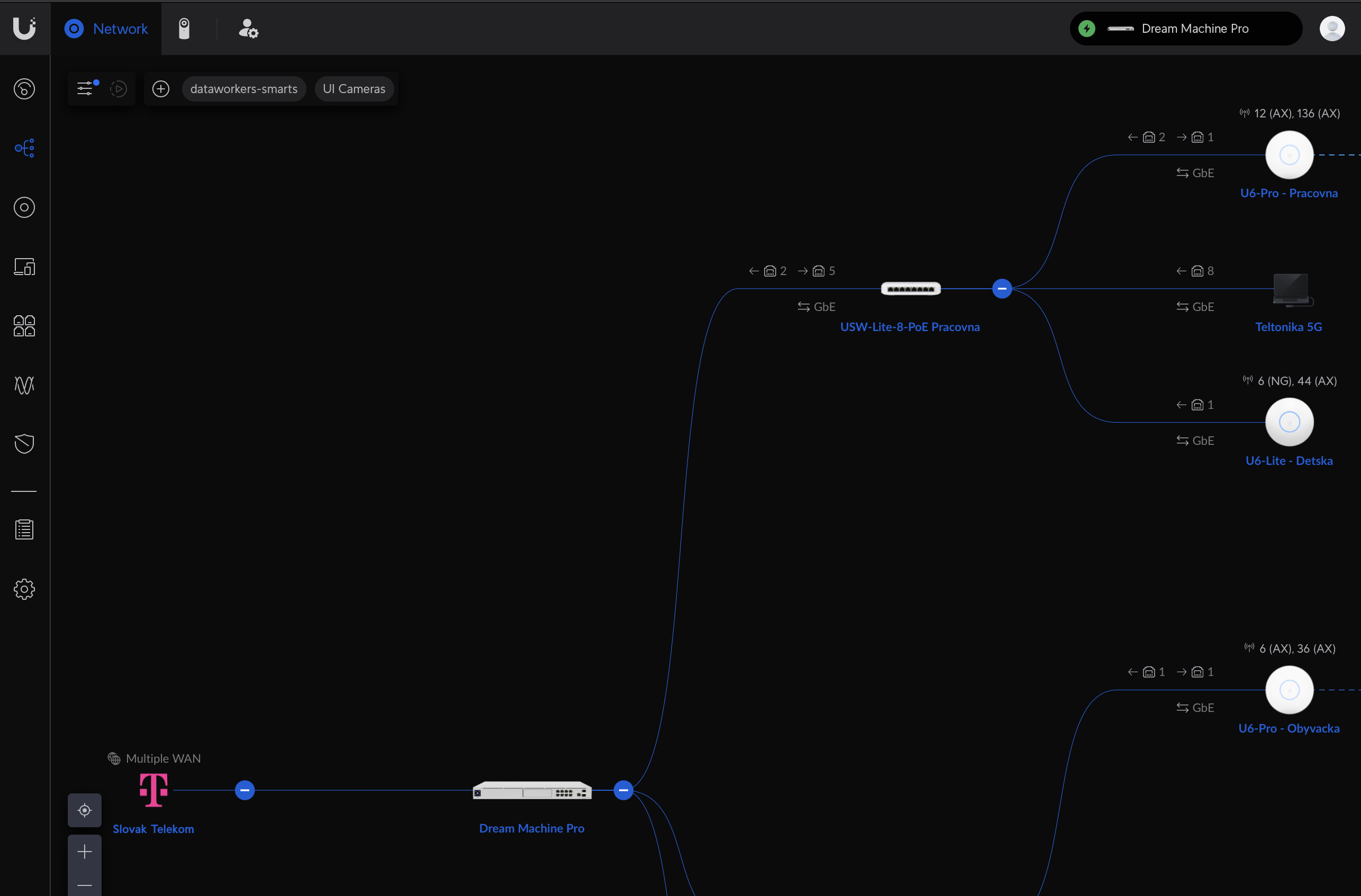

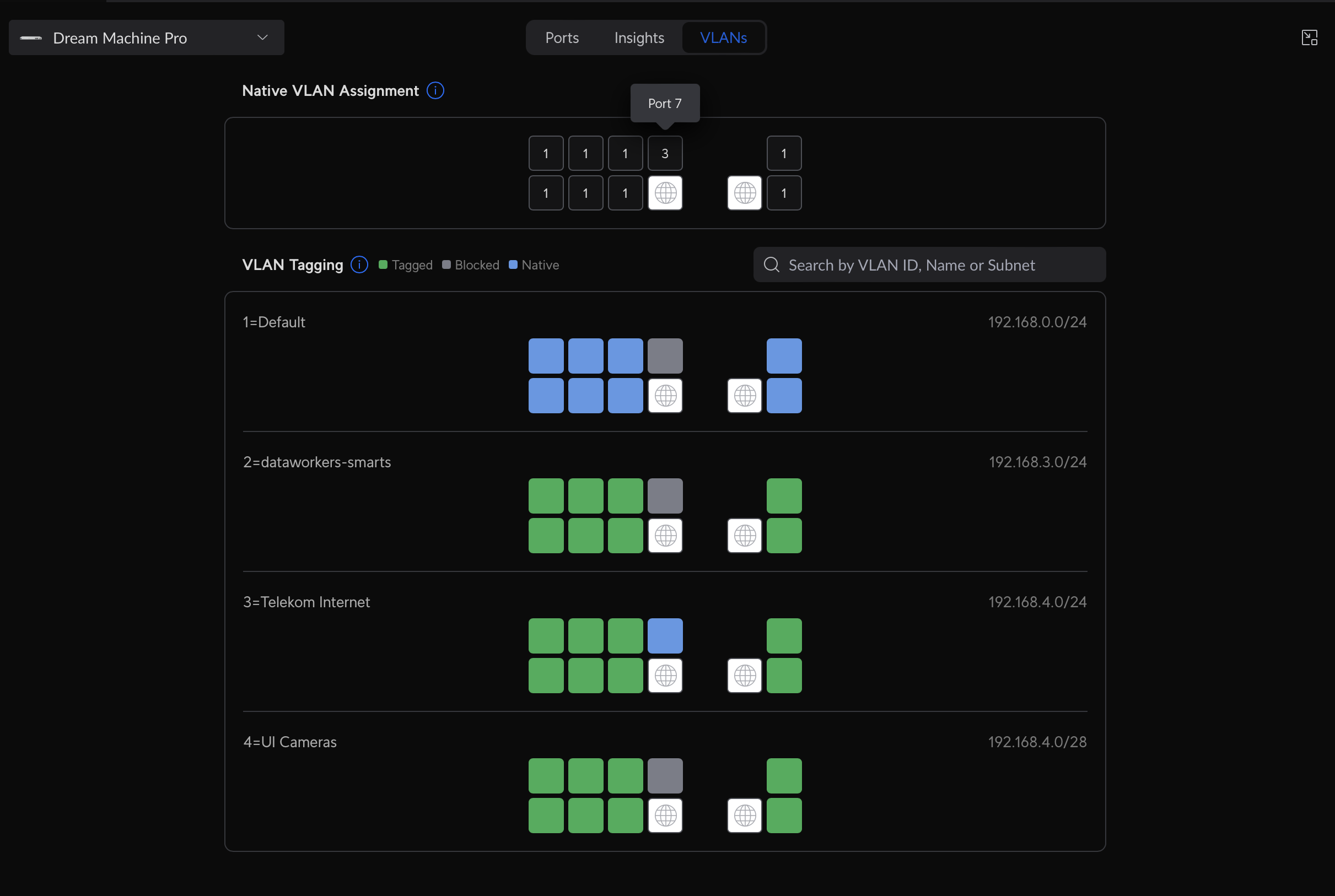

The configuration is as follows: TRB500 in Qumax omni enclosure, connected to Ubiquiti USW-Lite switch with VLAN id 3 and USW lite switch connected to the Unify DMP to port 7 with VLAN 3 - connected to WAN port 9 on Unify DMP. (See screenshots)
