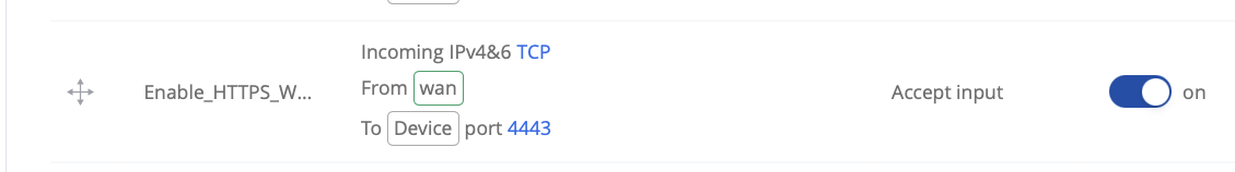

With http, I simply ticked in my static IP + Port, means xx.xx.xx.46:81. Now have a domain matching my static IP xx.xx.xx.46. This kind of adressing is with a domain not possible anymore and I land always on the router, although I want to reach my webserver behind. I already set incoming and outcoming Port to 443, the https port itself to 4443. Nothing works. Any idea how to solve it?

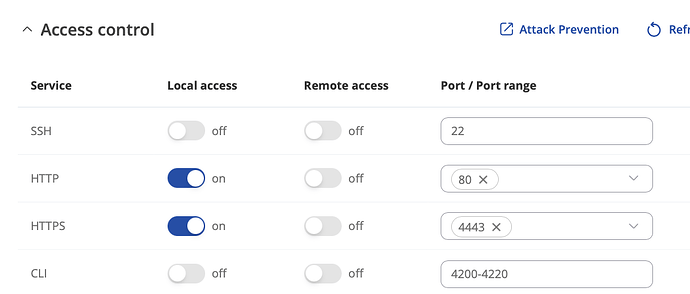

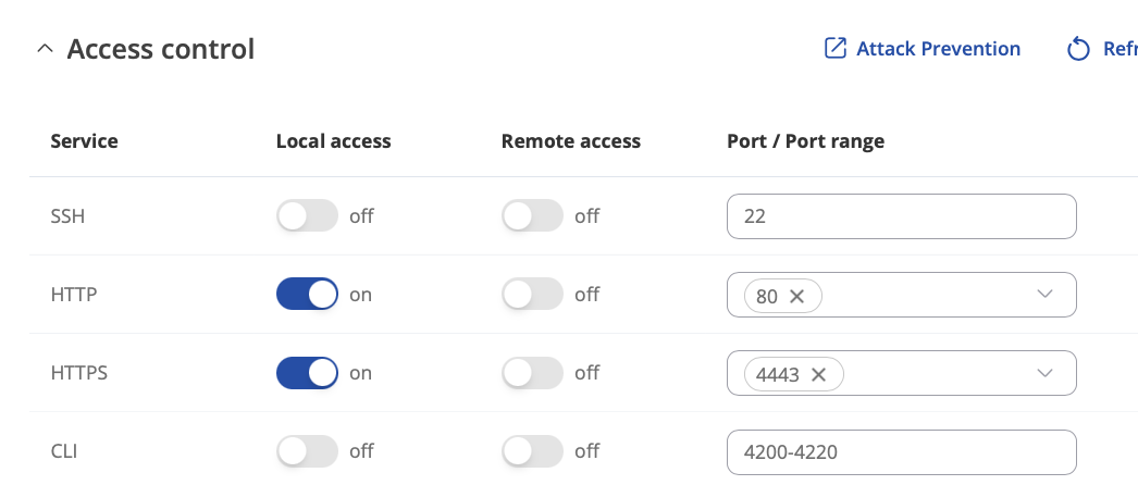

Check if the router’s HTTPS management interface is enabled on port 443 and either disable it or change it to a different port to free port 443 for forwarding.

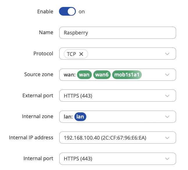

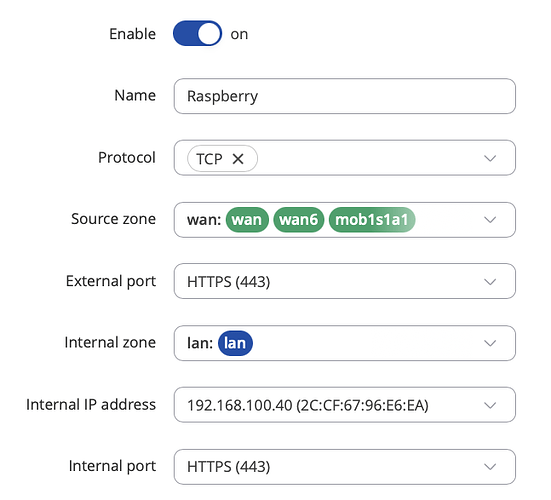

thank you for all the explanation. Is it possible to have a look to my configuration? I think meanwhile I tried every possible combination, meinmonitoring.de lands always on the login page of the router, although I can reach my Apache server on xxx.40 via Lan.
The Apache is listening to 443.
