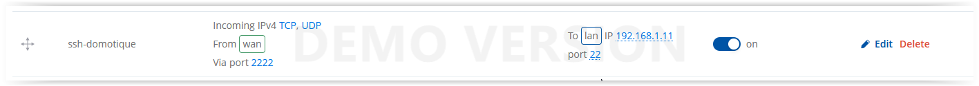

I try to forward the external port 2222 to 22 on a local computer.
I do a port forwards rule :
When I try to connect from my external ip to the port 2222, I receive a timeout.
If I connect to the port 22 with the root, I connect the RUTOS, and after a ssh to the port 22 on the 192.168.1.11 is ok.

I explain with samples :
1 - What I want from my computer at my office : $ ssh -p 2222 loveforever@
and I have as answer : ssh: connect to host port 2222: Connection refused

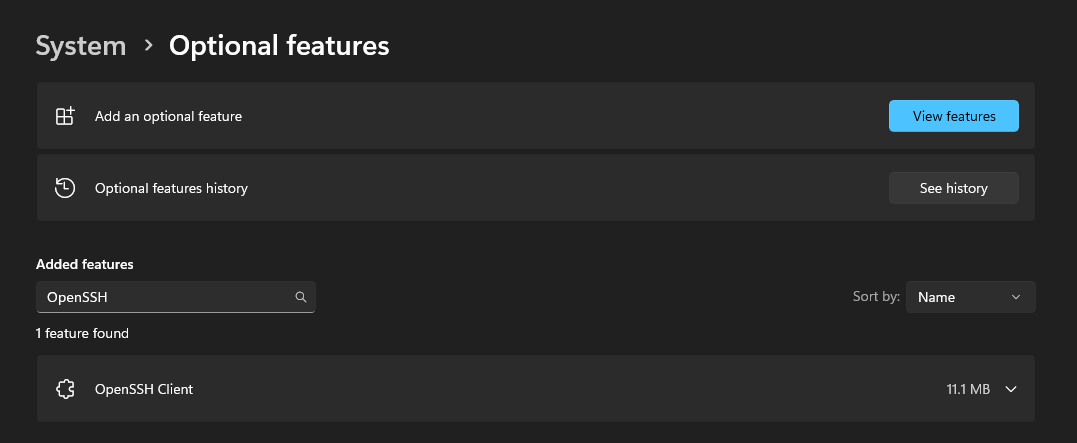

Hello, Marc,
This could also be related to the OS that you’re using, for example, Windows has this program called OpenSSH that should be pre-installed & the service of it should be running:
More information can be found here - let me know if this helps you out.
