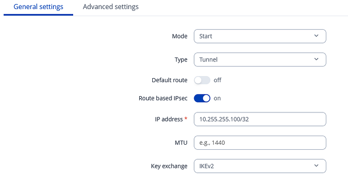

Proxy pairs is any-any, and I’m trying to enable route based with defaul route in the tunnel.
If I enable default route, the tunnel goes down and I cant seem to find any reason why; probably because then wan starts to direct its traffic to the tunnel? I added the wan-port to the passthrough interfaces, but it does not help.
Also tried adding remote and local ip addresses in advanced side. If I add those, tunnel goes down. I understood, that those ips would act as tunnel interface addresses?

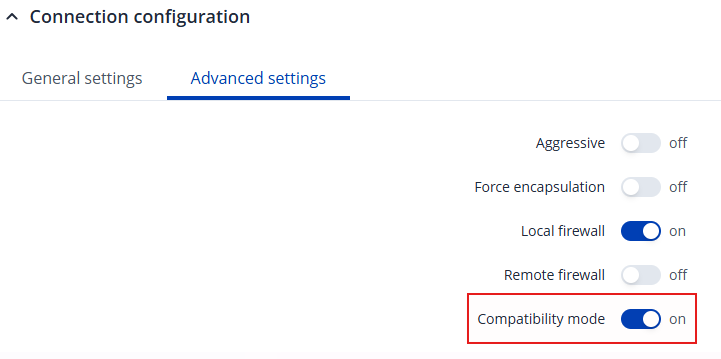

Could you please try enabling Compatibility mode under the Advanced settings of the connection configuration and check whether this resolves the issue?

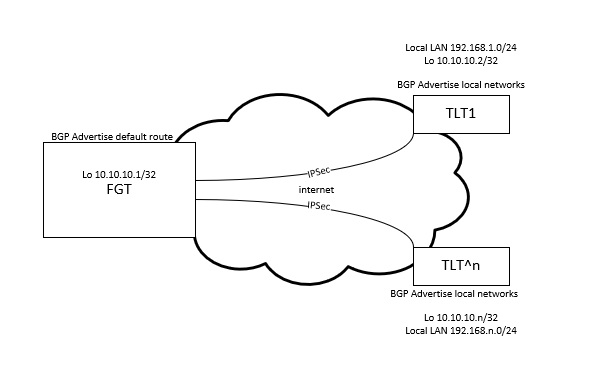

Could you share a simple sketch of your network topology, including IP addresses (please exclude any public IPs)?
Also, could you provide the current BGP configuration?
Ill try those setting, here is simplified network topology. Teltonikas routes are mostly random pubplic IP’s, so the ipsec tunnel needs to be dialup on fortigates side:

Adding above mentioned ‘Compatibility mode’ does not seem to help at all. When adding default route tab on, it tries to connect to the fortigate, and there is data, but apparently fortigate does not understand it, as it feels like it is not responding to it at all. Also, no errors on fortigate side.
