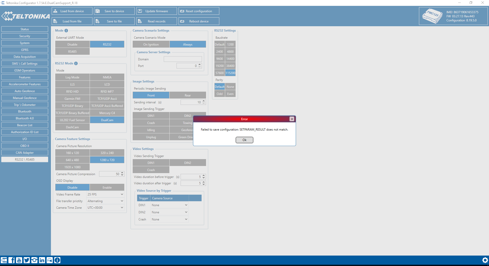

I am Facing the issue when connecting FMC125 Tracker with Dual Cam having Firmware Version FW:3.27.13.Rev.443 and the Configurator use 1.7.54…E.Dualcamsupport_R.18.
when going into the RS232 setting for Dual cam and press “SAVE TO DEVICE” button the error “SETPARAM_RESULT does not Match” Occur. i had use different configurator also but facing this same issue again and again.

Good day, kindly upgrade your device firmware to 03.27.13.Rev.663
Download it here:
Link: Firmware
Password: 3RpOAf96
For your reference you can check our wiki page for the device firmware errata: DualCam Firmware errata - Wiki Knowledge Base | Teltonika GPS (teltonika-gps.com)

The issue has been resolved by Upgrading the Firmware version of FMC125
