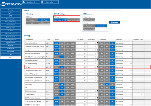

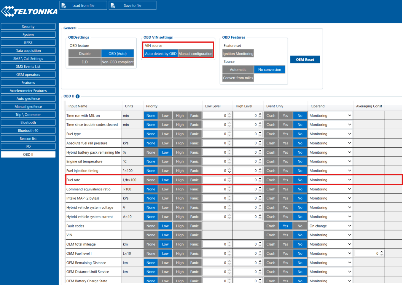

I hope you are doing well. Do the device were able to recognize the VIN number?
Kindly check if the device automatically recognizes the VIN number, else you may manually set the VIN number on the Configurator and see if you were able to get the parameters.
On the other hand, fuel consumed per trip is not available on the parameters. Either you may use Fuel rate as a workaround or calculate the Fuel changed to the odometer changed per trip through your platform.
