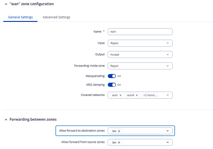

  • In the RUTX firewall zone settings, allow forwarding from the WAN zone to the destination LAN zone:
I hope this helps or at least gives you some useful insight into your desired setup.
