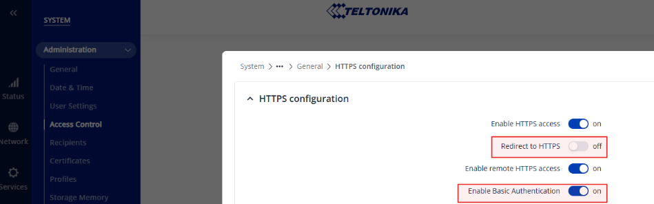

For API authentication there are 2 methods: Session Token Authentication and HTTP Basic authentication
You can find more information about them here: Fundamentals | Teltonika Networks Web API
If you decide to use HTTP Basic authentication, you will need to enable it under Network → Administration → Access Control, as shown in the picture below
