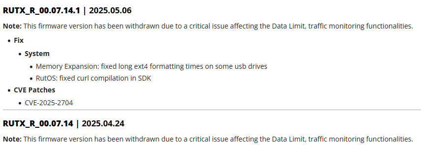

i did several RUTX_R_00.07.14.1 updates on RUTX50’s this week and notice on the website today it stated this note:
i did post a topic recently about data limit usage information being different compared to the RMS data usage information.
Please can you confirm if its best to downgrade devices to RUTX_R_00.07.13.4 or leave it till next firmware release?
Please can you confirm what the Data limit issue is that has caused the new firmware release to be withdrawn?
When is the next firmware released?
Kind Regards
I too would like to know if i should downgrade or wait?
Is the “Critical Issue” a serious security issue, or just a glitch?
Given that the firmware has been withdrawn does suggest that this is a security issue, is my home network at risk in some way.
We recommend downgrading to firmware version 7.13.4.
Version 7.14.2 should be available soon.
We apologize for any inconvenience this may have caused and appreciate your patience and understanding.
is there a security risk remaining on Firmware 7.14.1?
Due to issues with the Data Limit and Traffic Monitoring functionalities, firmware versions 7.14 and 7.14.1 have been removed.
If your device is currently operating on 7.14.1, please update it to 7.14.2 without using the “Keep settings” option to avoid these issues.
We apologize for any inconvenience this may cause and appreciate your understanding.
