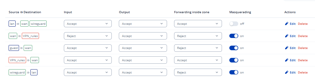

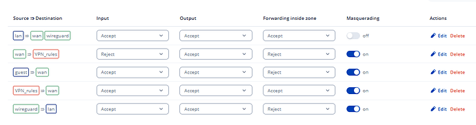

  • Firewall Zone :
I cannot deleted some rule test that I made maybe this come from the issu…

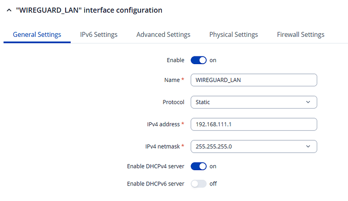

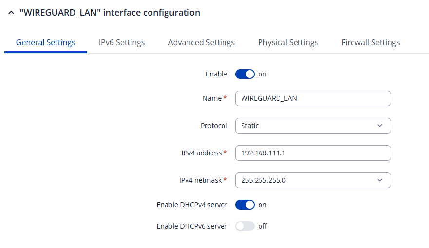

After resetting the device, create two additional LAN interfaces under Network → LAN, so you have a total of three interfaces: LAN, GUEST_LAN, WIREGUARD_LAN
Your configuration should look similar to the example below. USE the IP addresses you want:

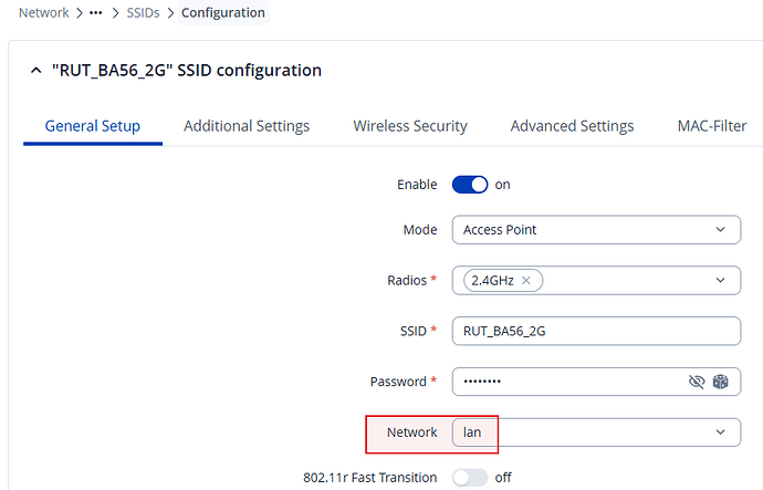

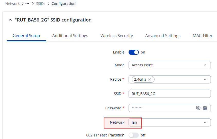

Next, configure your SSIDs under Network → Wireless → SSIDs
Ensure that the RUT_BA56_2G and RUT_BA56_5G SSIDs are assigned to the lan network:

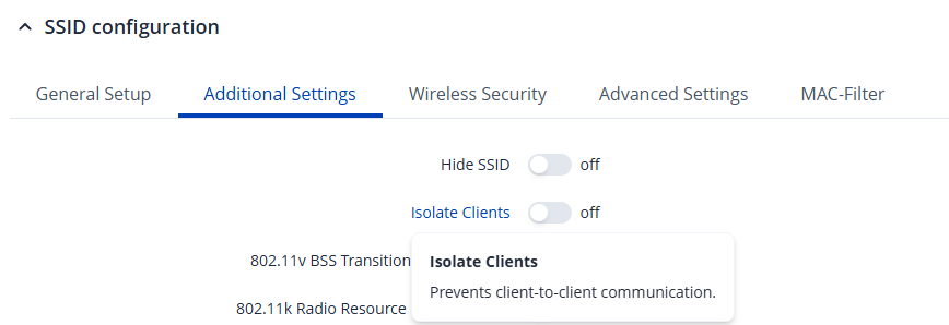

Create a new SSID for the guest network, configure its name and password, and assign it to the GUEST_LAN network.
Under Additional Settings, you may also enable the Isolate Clients option:

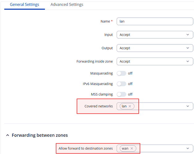

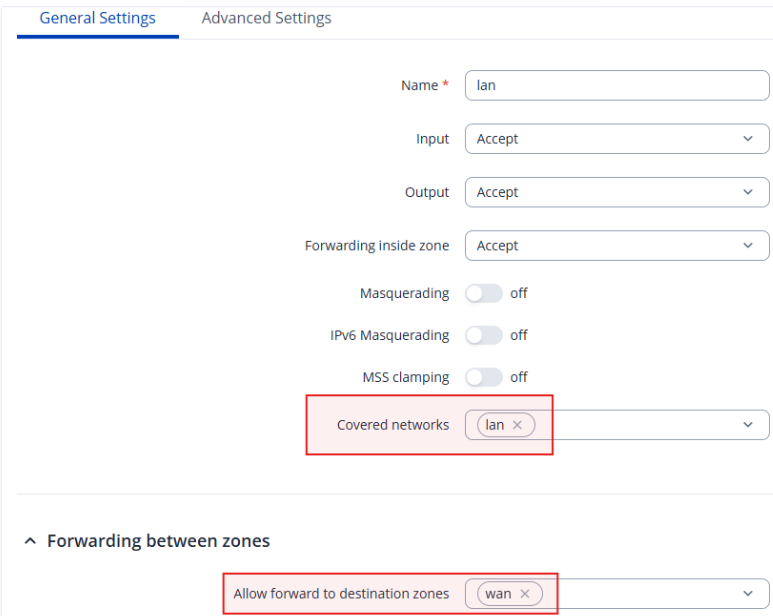

Once the wireless configuration is complete, navigate to Network → Firewall → Zones to isolate the networks.
For the default LAN zone, ensure that:

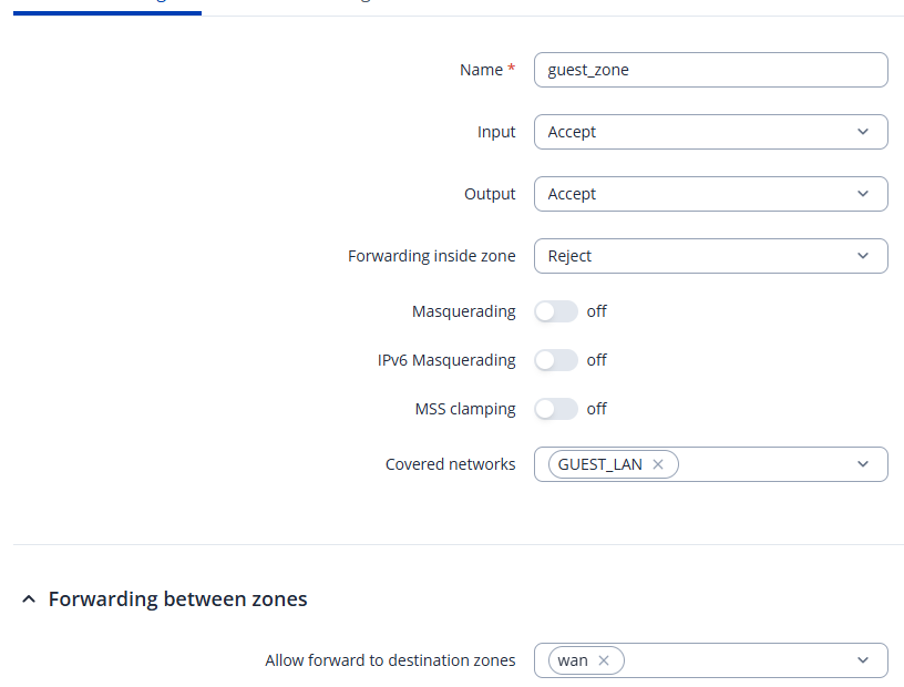

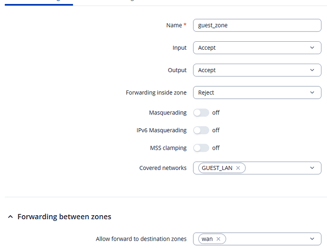

Next, create a new firewall zone for the guest network and configure it as shown below:

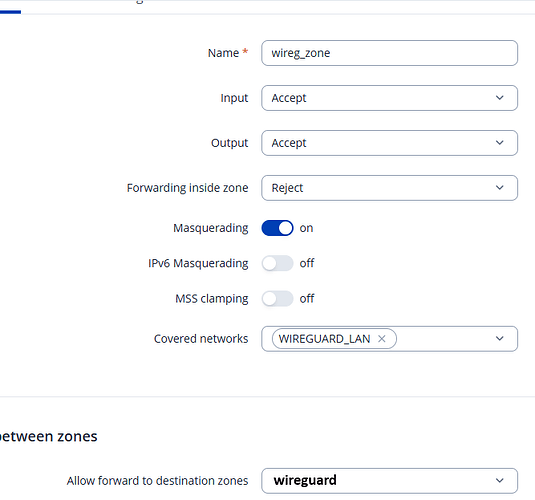

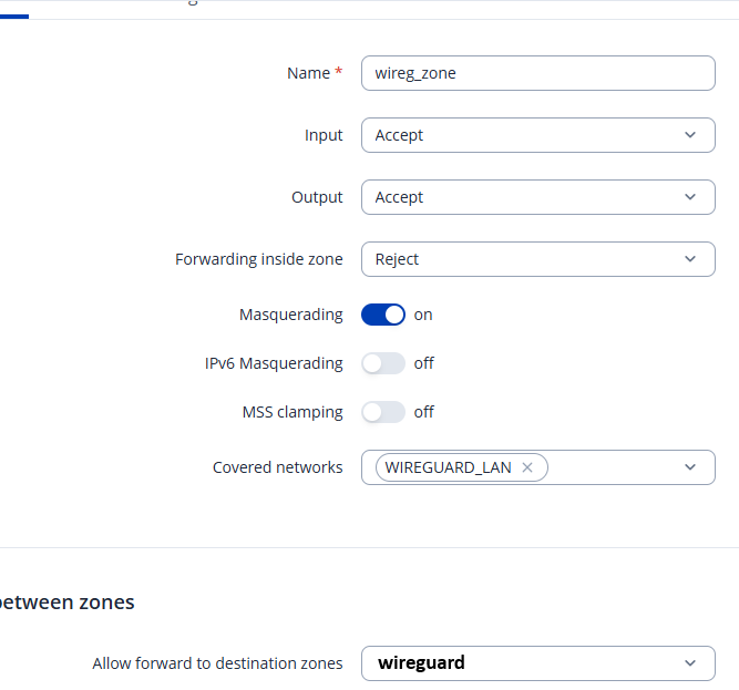

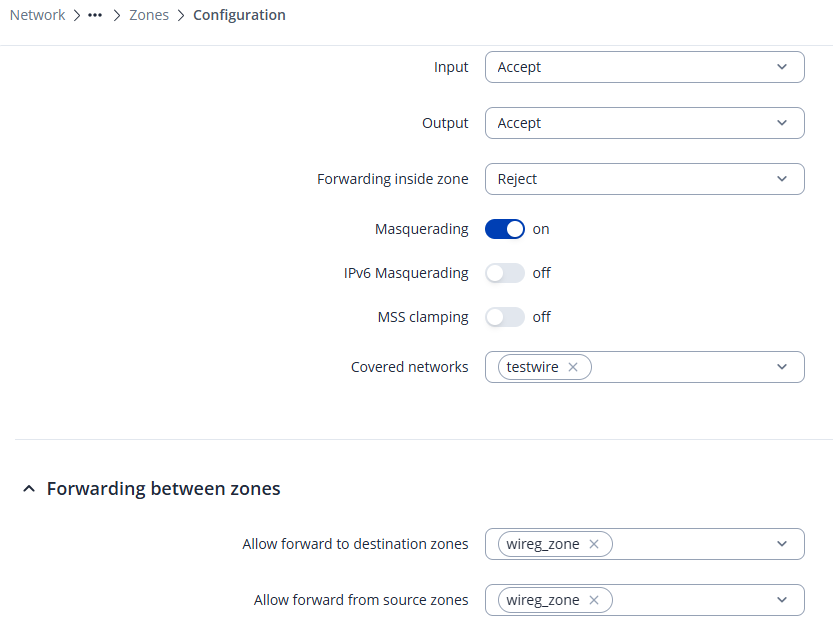

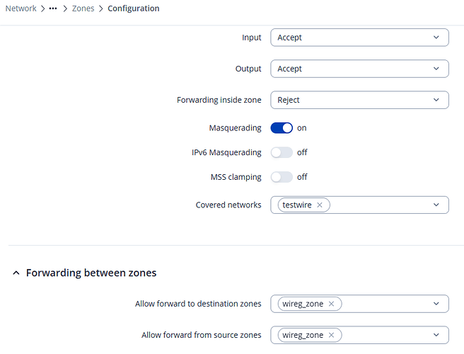

After that, create a firewall zone for the WireGuard network and configure it as shown in the following screenshot:
For the Allow forward to destination zones option, select the default wireguard zone that is automatically created when you
And in the default wireguard zone, the allowed zone should be only the new wireg_zone
