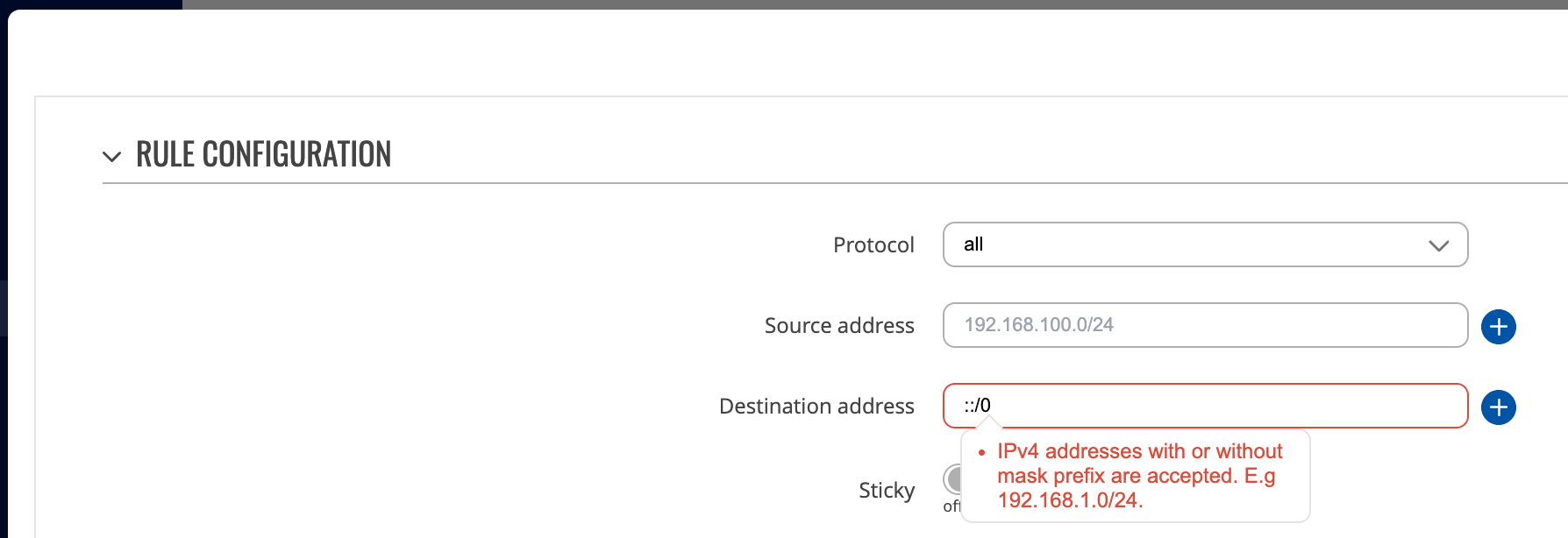

Here are some screenshots (Firmware 07.05) that show, you still can’t enter a V6 into the “destination address” field of a failover rule

This case is not considered a high priority one, so we decided to postpone the fix to a future firmware update. But I want to make sure you understand that this fix will not solve the problem you reported, because the router does not decide whether to use IPv4 or IPv6. That depends on the applications that run on your devices.
The router simply returns IPv4+IPv6 addresses via DNS queries, and then the client chooses which version to use. Most applications prefer IPv6, and thus will use the mobile connection.
If you are using IPv6 to reach the router itself, then it should be enough to disable RA and DHCPv6 on the LAN interface DHCP settings. This way the router will still obtain an IPv6 address, but it simply won’t distribute it to the LAN devices.
Okay, thank you for the clarification @Daumantas
So it is correct that the simplest fix for having >1 connection where not all of them support IPv6 is to disable IPv6 entirely on the LAN side, right?
Correct, either disable IPv6 for the clients, or change the client configuration to prefer IPv4/block IPv6.
