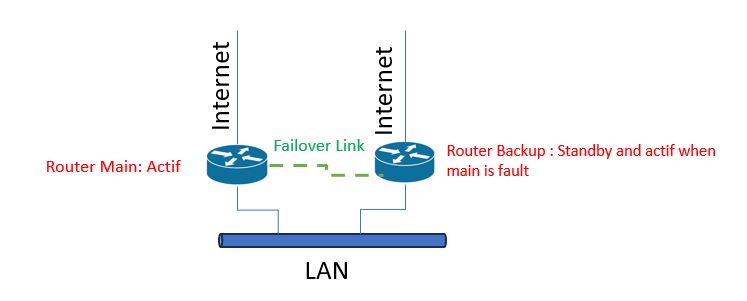

Is It possible to make failover Link between two Rut X11, Main Router active et Back-up routeur in standby mode. When main routeur is in state fault, Back-iup router is set to active automaticaly.
Photo in attachement.
Thank you all.

Our routers have Virtual Router Redundancy Protocol (VRRP ) which can be used as a failover.
On our wiki page, you can find a VRRP configuration example for 1 device: RUTX11 VRRP configuration - Teltonika Networks Wiki
The second device should be configured the same as the first one, but it is necessary to write down the correct priority. Router with higher priority will be Master (for example 255) and router with lower priority will be a Backup (for example 100).
if you would need additional help with configuration, please provide a topology with IP addressing that you currently have/use and the configuration that has been done so far.
