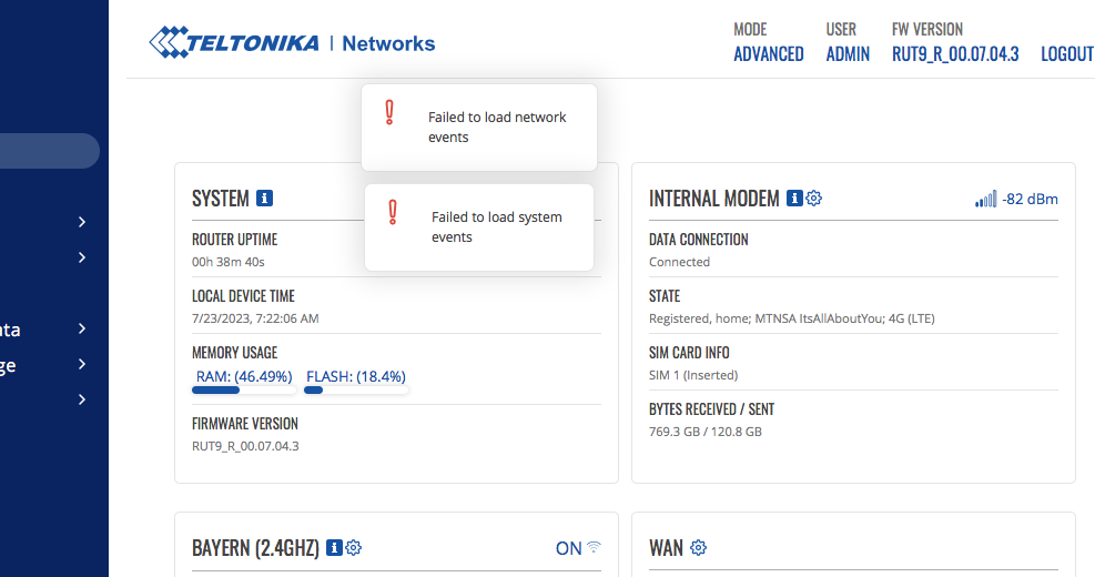

After upgrading to the version RUTx07.04.3 I am not able to view any logs. Every 5 seconds an error keeps appearing as per the attached screenshot. Any ideas? Thank you

Hi, thanks for the response. I have restored to factory defaults via the browser and then set up the router again but still the same problem. I reformatted via the reset button once and still the same. So after two factory default resets, still the same problem, I do not get the logs to record.
