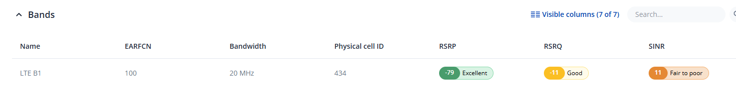

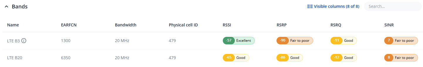

Here’s the actual mobile signal strength:
