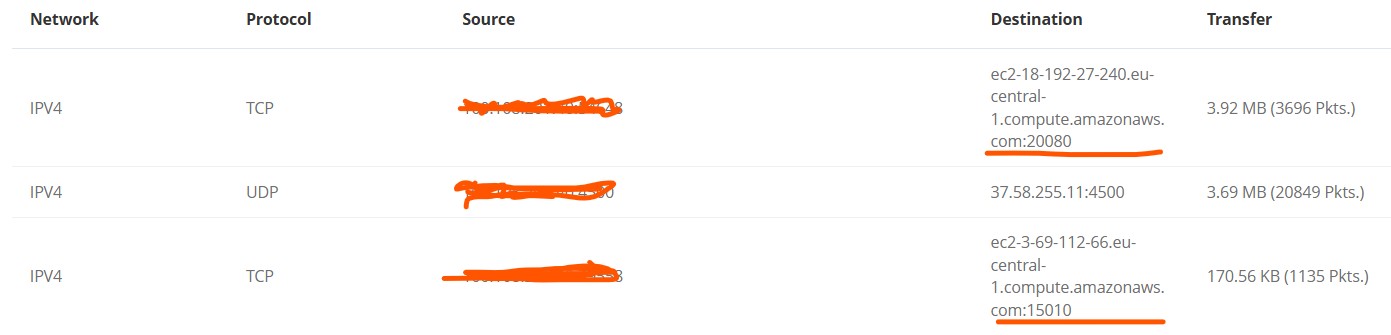

We have hundreds of RUT200 that started during this month to have data usage increased by 2000%. I have disconnected all devices from the router still high traffic. Does anyone had a similar situation? Thank you

ec2-18-192-27-240.eu-central-1.compute.amazonaws.com redirects to https://account.rms.teltonika-networks.com/. No need to reset device to factory defaults, just disable RMS service
