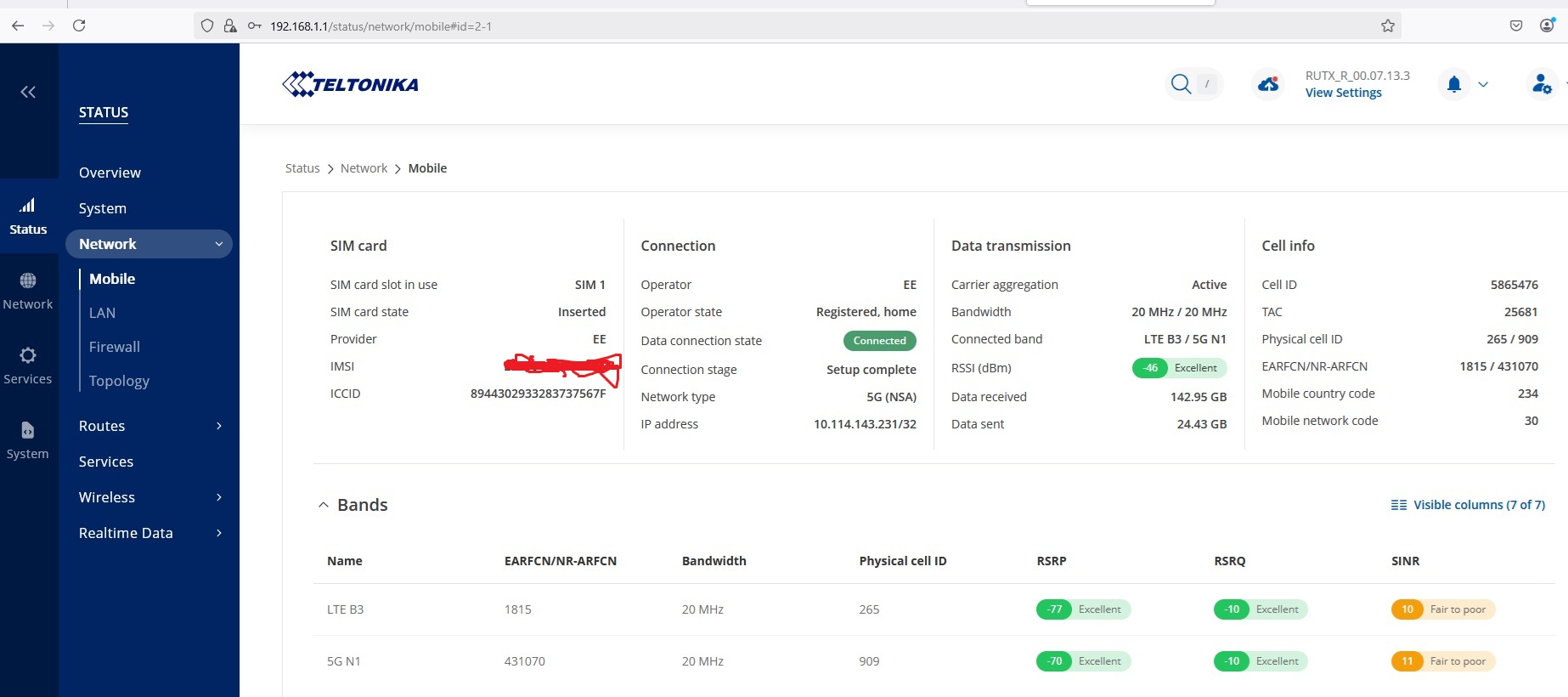

Can you give us a screenshot of this page: STATUS > NETWORK > MOBILE
If you can mask out the EMSI number.

Hi, I certainly can, screenshot is here. Answers to your questions are below:
The antenna is a Teltonika PR1KC640. There’s no other communication equipment anywhere on the boat, this is the only antenna of any kind. Neither is there any other kind of electrical equipment mounted near it. The 4 antenna connections are connected to the 4 mobile antenna SMAs on the back of the router, cables are 3m long with no joins. The router’s device and modem firmware are both up to date as well.

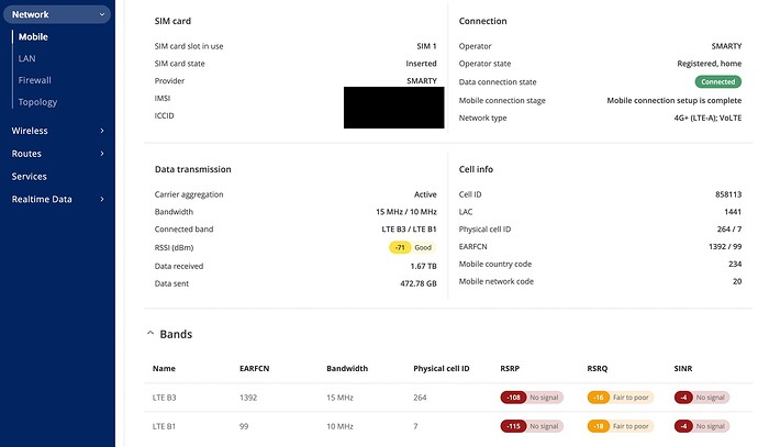

I hadn’t spotted that one, you’re right. Looking at your screenshot not knowing how far away you were at the time from the mobile mast that you were connected to, the signal strength is very poor indeed and the two bands being used at the time are 10 & 15Mhz, so the speed will have been very slow and because of the poor signal i’ll bet your experiencing a lot of disconnections too.
