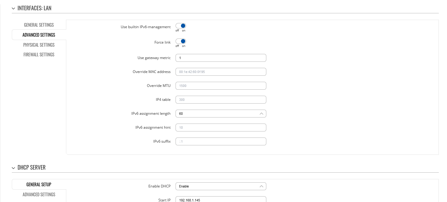

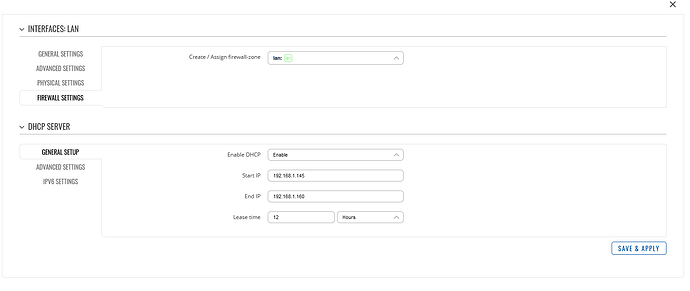

  • Lan 1 (192.168.1.1) with DHCP is connected to my computer
  • Lan 2 is connected to a router with IP address is 192.168.202.254
  • Mobile Network in Rutx50 will be used after with a failover

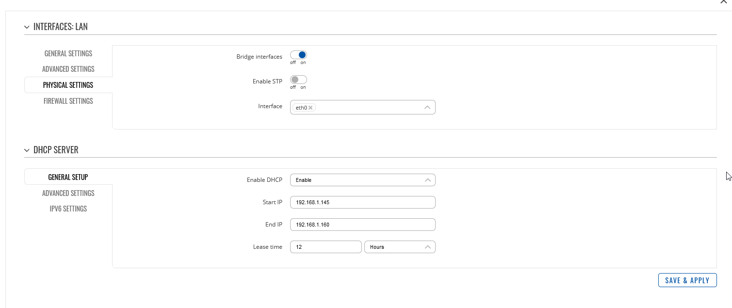

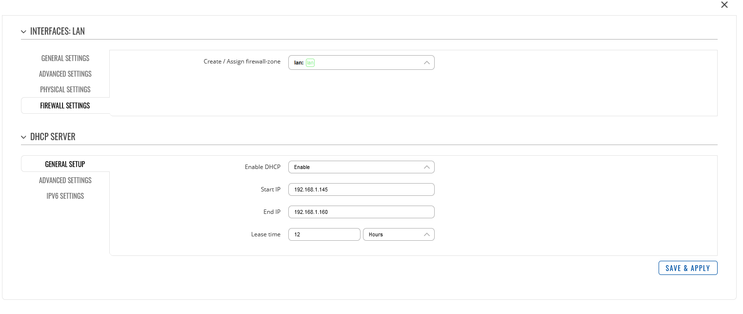

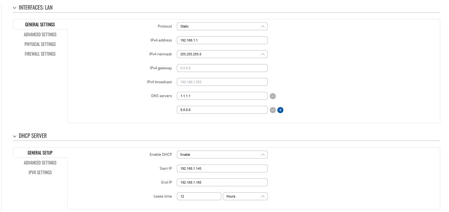

LAN 1 is configure as below:

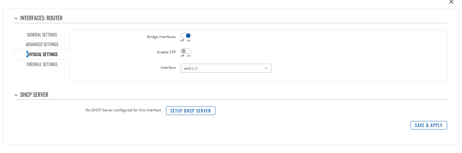

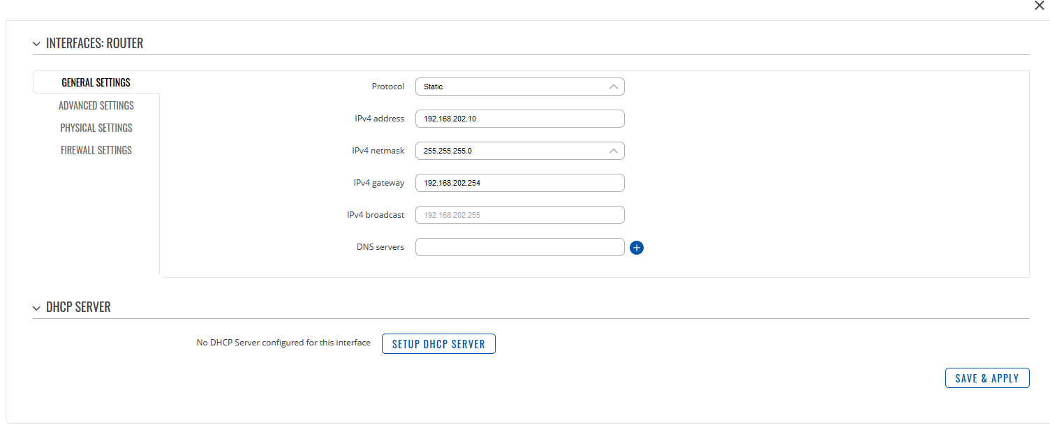

LAN 2 is configure as below:

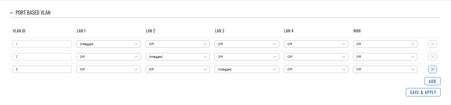

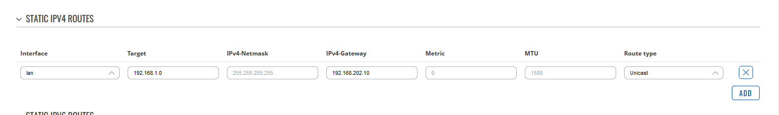

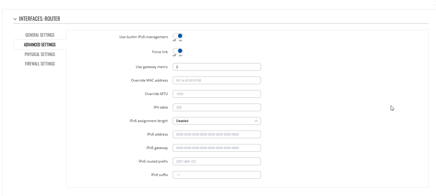

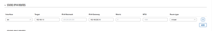

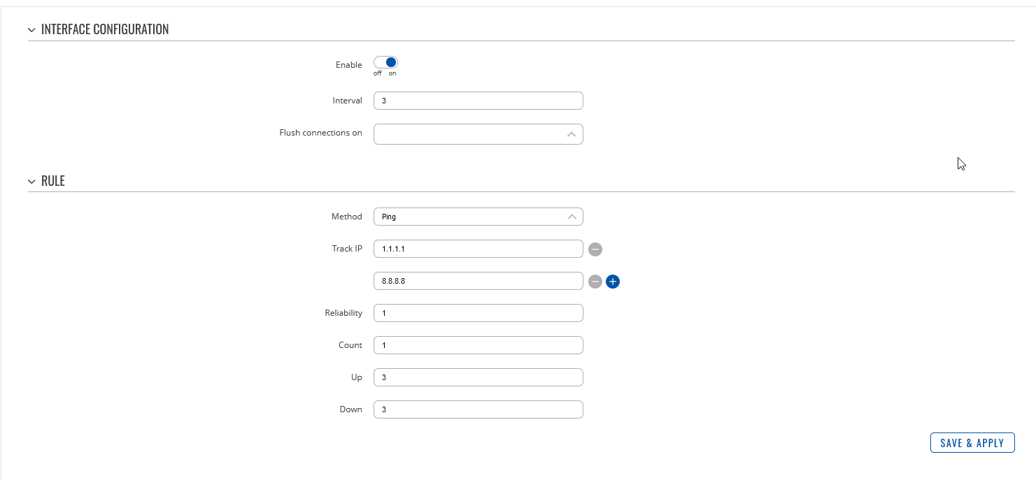

I configure VLAN, static routes, and failover as below:
In this configuration, I can’t ping my router (in LAN 2) through my computer ans I haven’t access to the internet.
However, all status are in green state.

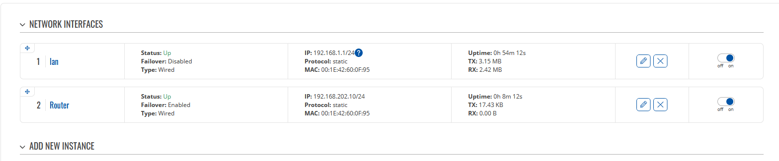

See Network Interfaces on top of this topic and Failover below:

A few notes:
  1. VLAN IDs 1 and 2 are used by the system. I suggest you put VLAN ID 2 for WAN as untagged, and remove LAN 2 port from it. You can create a new VLAN ID and add LAN port 2 to it as untagged.

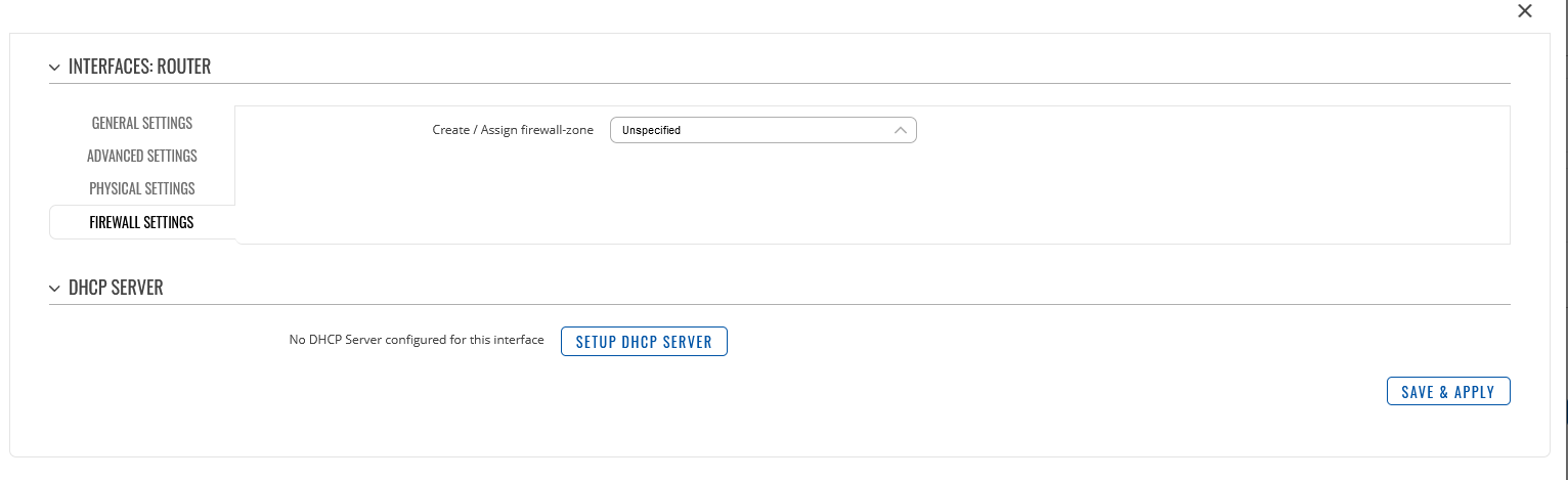

  2. Currently, LAN2 is not assigned to any firewall zone. I suggest you add it to the LAN zone. You can find more information about Inter-zone communication here. This article should help you to understand how to allow or block communications between networks.
  3. Check if you have a route to the second 192.168.202.0/24 network (here). If not, add a static route in Network → Routing → Static routes (information here).
Hello AndzejJ,
Everything works correctly with your explanation.
My principal problem was with the firewall.
Thank you for your help.
