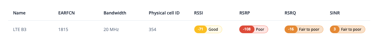

Ah - I have found this:
Here are some numbers:
The other bands are all worse.
Question: would an antenna with more gain help? Note that the RSSI is “good”, so maybe just increasing the signal strength would not be helpful, i.e. it would amplify the noise as well as the signal.
Does anyone know what the gain of the supplied antenna is?
I would still love to hear actual speed numbers from others, for comparison! Thanks!
