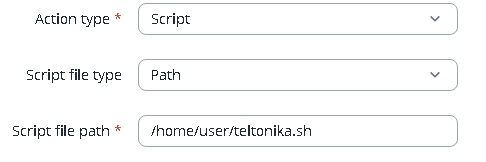

    In the I/O Juggler action, did you upload the script directly in the rule or did you specify a script path? Note that the RUT956 has a Custom Scripts section in the web UI that is intended for scripts executed at boot via /etc/rc.local, which is separate from the scripts uploaded in I/O Juggler actions.

  2. Whether I upload the script normally or from a path does not change the fact that it is executed incorrectly.

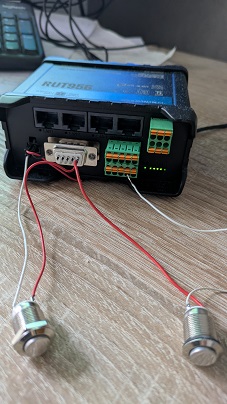

Hello, I’m back with a test setup. The whoami command isn’t implemented, so I’ve been testing the necessary permissions. I’m using the two keys to start a script that sets coordinates.
Example:
#!/bin/ash
#uci set gps.testvalue1=test
#uci commit gps
#latitude=‘52.344509’
#longitude=‘14.515258’
latitude=‘52.343528’
longitude=‘14.517436’
uci set gps.standort.longitude=$longitude
uci set gps.standort.latitude=$latitude
uci commit gps
#/etc/init.d/gpsd reload
First problem: it wasn’t always executed. So, as feedback for the key press, I enabled the internal relay to click. After the key press was audibly registered, sometimes only after the third attempt or a pause (for some reason), I was able to track the change in coordinates under Services/GPS/GPS Geofencing/location. The result: Executable (666) isn’t sufficient. The script located in usr/local/home/user requires at least permissions 766. Only then are the geofence coordinates reset. However, you definitely have to access it via GPS Geofence/Variable and the Event Type Log. I haven’t figured out how to change the coordinates in the Event Juggler/Event Type GPS. Perhaps someone knows more about that. I haven’t yet tested whether an alarm is triggered when leaving the newly set geofence; everything is still on my desk.
Regards

  2. Script action configuration: As a reminder, the Event Juggler Script action supports two modes — Upload (upload the script file directly) or Path (specify the full path to the script file on the device). Either way, the execute permission must be set correctly.
