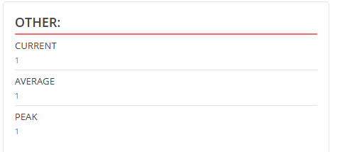

While looking in the router (Teltonika RUT240) I see the amount is less then 80 connections, UDP max 60 and TCP max 20. I saw also other connection type but that was at maximum 2. I dod not know what the another connection is.
When the issue occurs, I see in the overview the other connections go to 1.
At the moment it occured the amount if conenctions were for UDP 25 and TCP 10 and others 1.
