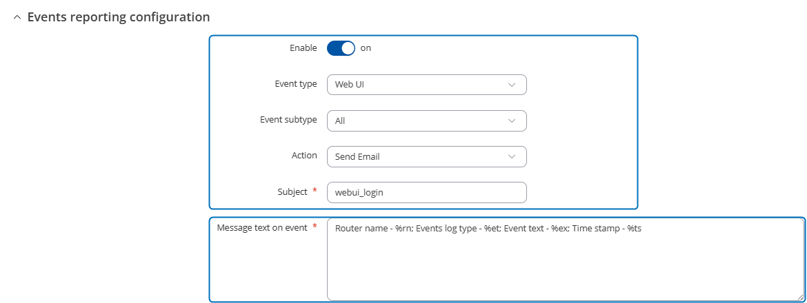

This goes for Events Reporting, as well as for the new Event Juggler. From the Events Reporting sending the test mail does work just fine and gets received.
To check if it was something altered, or a glitch in the config, I reset the RUTX50 to factory defaults to test on R_00.07.14.1, but even with a minimal config it would not work.
For the life of me, I cannot find any specific info in the logs to point me in the right direction, accept “daemon.err event_juggler: Failed to send mail”.

To be sure if anything had changed, I reset the configuration to factory defaults again after upgrading to RUTC_R_00.07.14.2.
Regretfully, no change and still the same error.
After some more testing and giving up on email reporting, I checked to see what would happen via SMS. Guess what, that does work!
Could it be that something is off in the template for sending the emails?
In all honesty, this is getting rather frustrating…
This thing is driving me nuts… :zany_face:
Could one of the professionals around here please have a look and tell me that I am an idiot and my config is pear-shaped, or see if there is something fishy going on?

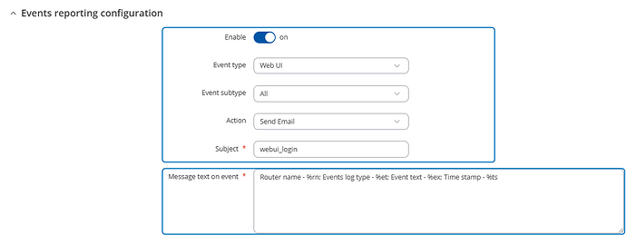

A this point there is nothing configured in either services for Events Reporting, or in Event Juggler (both services disabled).
1. I tried with a simple test (alert via email for all logins to the router) in Events Reporting and the config looks like this:

The test mail is sent and received 3 seconds later.
The Events Reporting service is enabled and the Event Juggler service disabled.
To test, I log off and back in again.
Only messages in the System log:

The first thing I’d recommend is to make sure you’re using either the Events Reporting service or the Event Juggler at a time, but not both simultaneously for the same notification triggers.
Additionally, please verify that the correct SMTP server settings are in place — if you’re using Google’s SMTP server, ensure it’s configured to use port 587 (TLS).
For reference, with a basic Event Reporting configuration for a WebUI login event on the 7.14.2 firmware, email notifications worked as intended.
Config example for reference
Let me know if the issue still persists. Additional information (screenshots, logs, etc.) would be helpful and appreciated.
Good morning gents and thank you so much for getting back to me!
The easy part in this matter is, that the server is an Exchange server that I keep on-prem and monitoring mailflows is quite easy.
That is why I can confirm that the mails generated by the events don’t even get to the server and that is why it is boggling me that the test mails do arrive.
And most frustrating is, that everything used to work flawless untill the mentioned firmware updates.
Nothing was changed in the config, still it all came to a screaming halt.
As for the 2 services, I have absolutely seperated the 2 and in the testing above I double checked.
