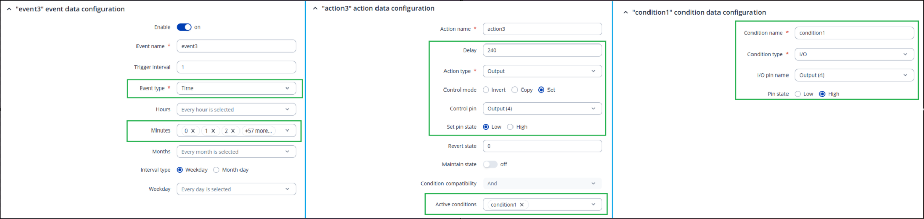

how can I set Event Juggler so that when the I/O output goes to 1 or true, it automatically goes back to 0 (i.e., off, false) after 5 minutes? Is that possible?
Since Event Juggler functionality does NOT have a dedicated I/O Output trigger, this can only be done indirectly.

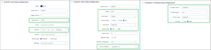

I found the following configuration to be working, but note that it has some randomness to it, because of the “Time-Minutes” trigger, which in essence checks if I/O Output is activated only once a minute. I.e., this approach has a 1-minute error, depending on the exact second value of the minute output that was triggered. Hence, with this approach, the I/O output will be deactivated within 4-5 minutes. You can, of course, change the “delay” value to adjust this time to e.g. 4.5-5.5 minutes or 5-6 minutes.
