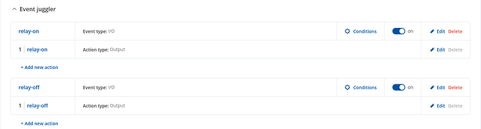

My event juggler page:

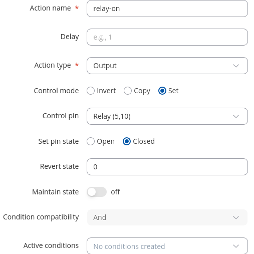

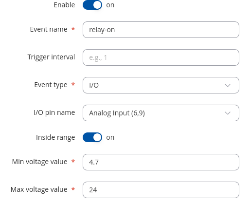

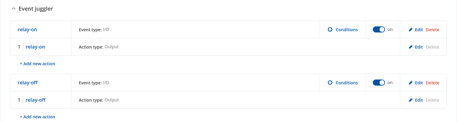

In the relay-on event I have the following:

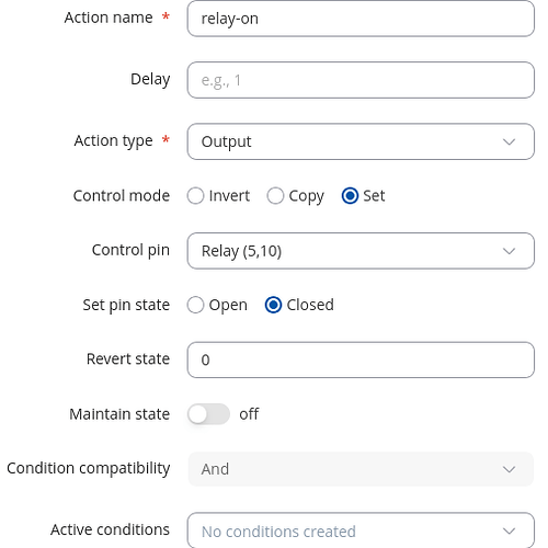

And the action for relay-on:

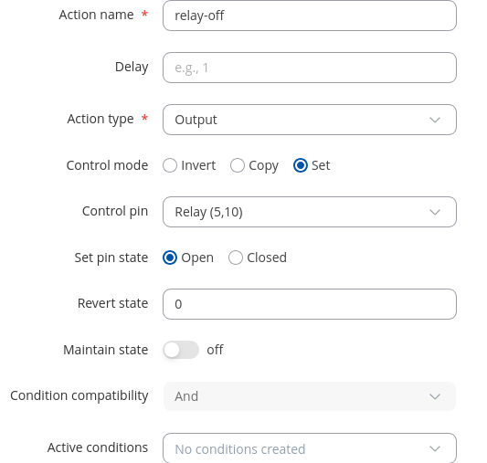

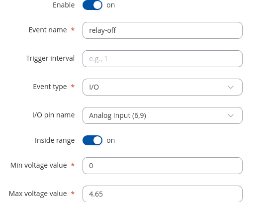

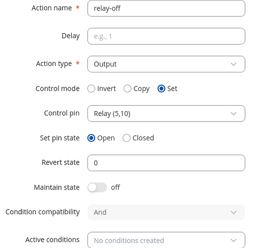

In the relay-off event:
And the action for relay-off:
At one point I was able to close the relay by having a time event triggering every minute and a condition to check the analog voltage. However I was not able to open the relay with a second condition and action in the same event. Any advice what I am doing wrong?
Firstly, I’d recommend updating your RUT956 firmware to version 7.15.2 (or the upcoming 7.15.3 soon). If feasible, perform the update without keeping settings to ensure a clean environment after the update.
Additionally, for testing purposes, please try setting the Revert state option to empty on both actions.
