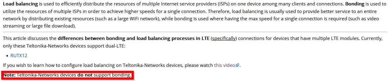

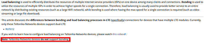

Is there anything wrong maybe syntax wise or option name wise in the addition to etc/config/network thats obvious?
I noticed you’re working on a bonding solution. Unfortunately, Teltonika-Networks devices do not support bonding.
