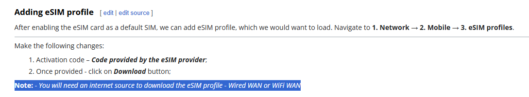

This looks to be mentioned under the Adding eSIM profile section:
Found here: ESIM Configuration example - Teltonika Networks Wiki
As mentioned, I will most definitely register this feedback with our R&D, so it is definitely possible that these improvements will be made in the near future.
Hi Matas, and thank for your reply and accepting my comments in the constructive spirit with which I intended :slight_smile: As regards the small footprint note “Note: - You will need an internet source to download the eSIM profile - Wired WAN or WiFi WAN”, this is confusing to many readers since they might understandably think “OK, I already have internet on my laptop that I use to access the Teltonika GUI…so surely I can download the eSIM.” Perhaps a HUGE banner at the top of the page would help set clear expectations? For example: “IMPORTANT: Your Teltonika router requires it’s wired Ethernet WAN port to be temporariliy connected to a 2nd Internet connection, such as another router or hotspot device, whilst it downloads the eSIM profile for the 1st time. Once the eSIM has been provisioned onto your router you can disconnect the wired WAN port.” (Most Teltonika routers, out of the box, do not provide facility for the Wi-Fi to act as a Wi-Fi client therefore only the wired Ethernet WAN port is suitable.)
