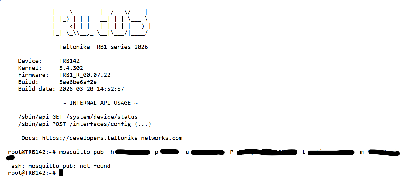

I am kinda new to Teltonika devices. I want ot be alble to sent MQTT messages via CLI on my Trb142. I have seen multiple post about this(such as this: How to use MQTT from CLI - I need to publish from CLI ) however the suggested methods seem to drop errors for me. So I wonder if there is a solution for me to use mosquitto or have any other method to send MQTT messages via the CLI. Oh and btw my firmware version is TRB1_R_00.07.22 if that matters.
Please help
root@TRB142:~# opkg -e /etc/opkg/openwrt/distfeeds.conf update
Downloading https://downloads.openwrt.org/releases/21.02.0/targets/mdm9x07/generic/packages/Packages.gz
*** Failed to download the package list from https://downloads.openwrt.org/releases/21.02.0/targets/mdm9x07/generic/packages/Packages.gz
Downloading https://downloads.openwrt.org/releases/21.02.0/packages/arm_cortex-a7_neon-vfpv4/base/Packages.gz
Updated list of available packages in /var/opkg-lists/openwrt_base
Downloading https://downloads.openwrt.org/releases/21.02.0/packages/arm_cortex-a7_neon-vfpv4/base/Packages.sig
Signature check passed.
Downloading https://downloads.openwrt.org/releases/21.02.0/packages/arm_cortex-a7_neon-vfpv4/vuci/Packages.gz
*** Failed to download the package list from https://downloads.openwrt.org/releases/21.02.0/packages/arm_cortex-a7_neon-vfpv4/vuci/Packages.gz
Collected errors:
* opkg_download: Failed to download https://downloads.openwrt.org/releases/21.02.0/targets/mdm9x07/generic/packages/Packages.gz, wget returned 8.
* opkg_download: Failed to download https://downloads.openwrt.org/releases/21.02.0/packages/arm_cortex-a7_neon-vfpv4/vuci/Packages.gz, wget returned 8.
root@TRB142:~# opkg -e /etc/opkg/openwrt/distfeeds.conf install mosquitto-client-ssl
Unknown package 'mosquitto-client-ssl'.
Package installation encountered an error, removing previously installed packages.
