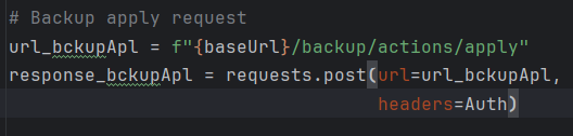

Hi, I got a problem with backup apply through API. I need help with syntax (at least I think that it is syntax, still new to this).
Here is the code I need help with:
Next here is the error message I get:
{‘success’: False, ‘errors’: [{‘source’: ‘Validation’, ‘code’: 102, ‘error’: ‘No arguments provided for action’, ‘section’: ‘apply’}]}

I think you still need to provide at least the empty data object. This should work:
post_data = {"data":{}}
response = requests.post(url=..., headers =..., json = post_data)
Or with disabled encrypt value:
post_data = {"data":{"encrypt": "0"}}
