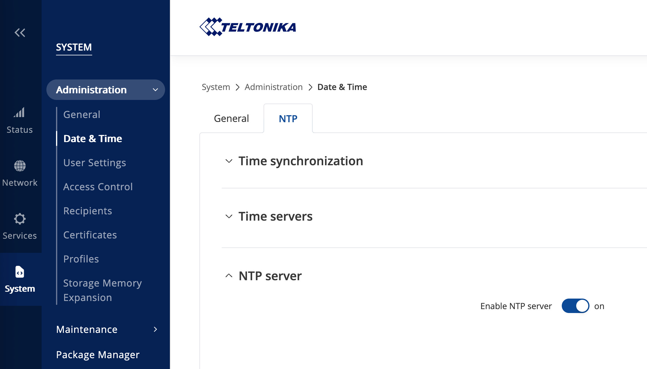

Enable NTP server at System → Administration → Date & Time

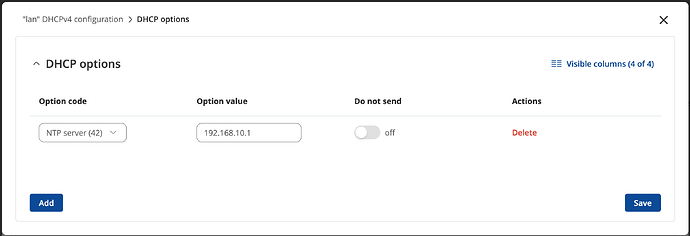

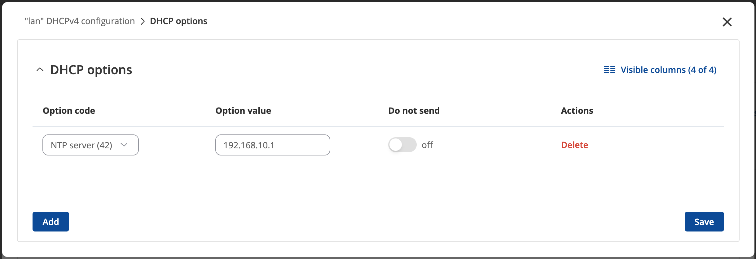

To automatically “tell” DHCP client devices on your LAN to use the RUTX11 as their NTP server, you can suggest it by passing DHCP option 42:

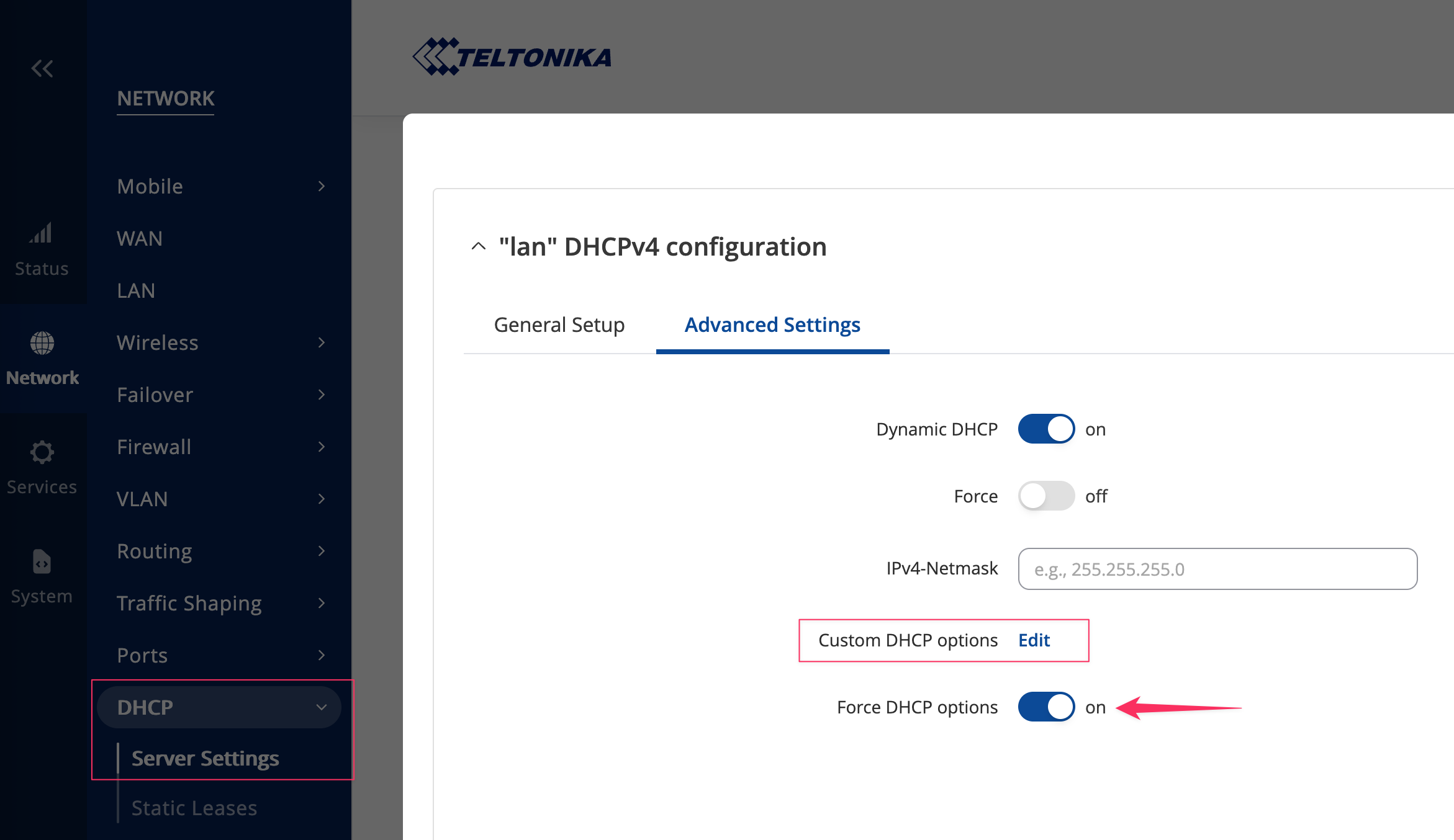

Network → DHCP → Server Settings → Custom DHCP options
Try enabling the Force option if it still doesn’t work…

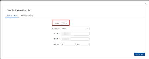

Thanks for the instruction. I was wondering if dhcpv4 should be allowed?
Are you using any other device to handle DHCP the network? You shouldn’t have 2 DHCP servers on the same broadcast domain, but generally yes, you would leave the “lan” DHCP server enabled. Otherwise, if you do want to use a different device for your DHCP service, make sure to configure option 42 on it so it directs clients to the NTP running on the RUTX11.
