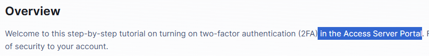

As far as I understand it is possible to do this for OpenVPN as well:
I just assume the way RMS is using OpenVPN, it is not enabled / exposed to us users?
Hanno
You are correct, the link you provided does explain how to set up 2FA, but it shows how to set the 2FA to connect to the OpenVPN Connect app, and not to initiate a connection to the actual server.
