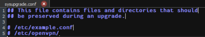

When performing a backup, only files deemed necessary are saved. Therefore, if there are specific files or folders you wish to include in the backup, you must add their paths manually. This can be done in the /etc/sysupgrade.conf file.
2024-03-15-15-51-52-MobaTextEditor
Additionally, it’s important to note that creating a backup file first and then adding files to it is not the recommended approach. Instead, you should configure the device as desired, ensuring all required files are present, and then create the backup. This ensures that all dependencies are properly accounted for during the backup creation process.

  1. I installed all the packages, and edited my sysupgrade.conf file as follows, on the device itself:
## This file contains files and directories that should
## be preserved during an upgrade.
# /etc/example.conf
# /etc/openvpn/
/root/
/etc/backup_packages/
