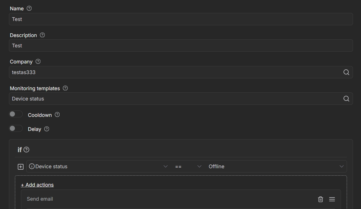

Adding a specific “timer”, as you mention, 1 hour for example, will be a bit tricky, since there’s no such function. However, you may set up just an instant notification of when the device goes offline, like so:

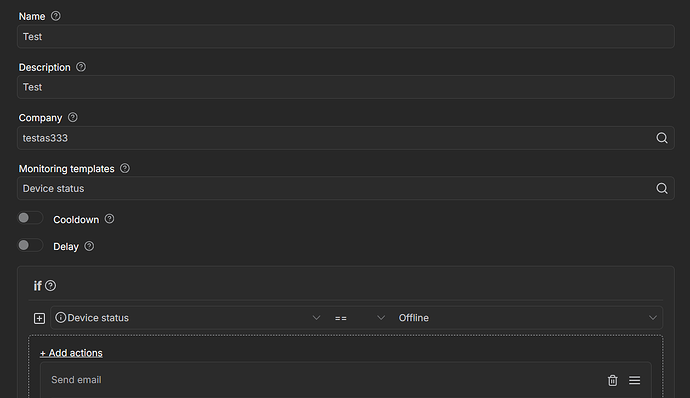

You could try setting up Device status instead, and play around with the Delay/Cooldown options to see what suits you best:
This should constantly send you e-mails, unless you set up a cooldownl.

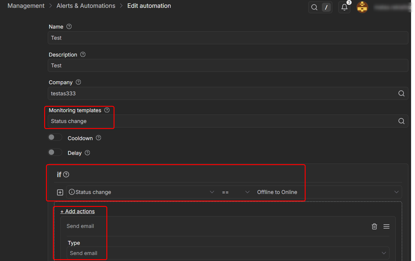

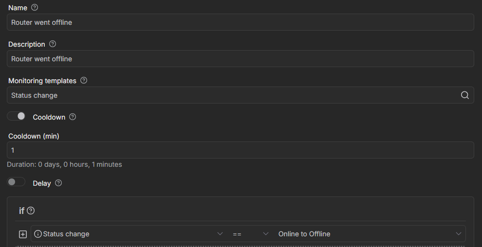

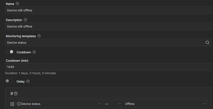

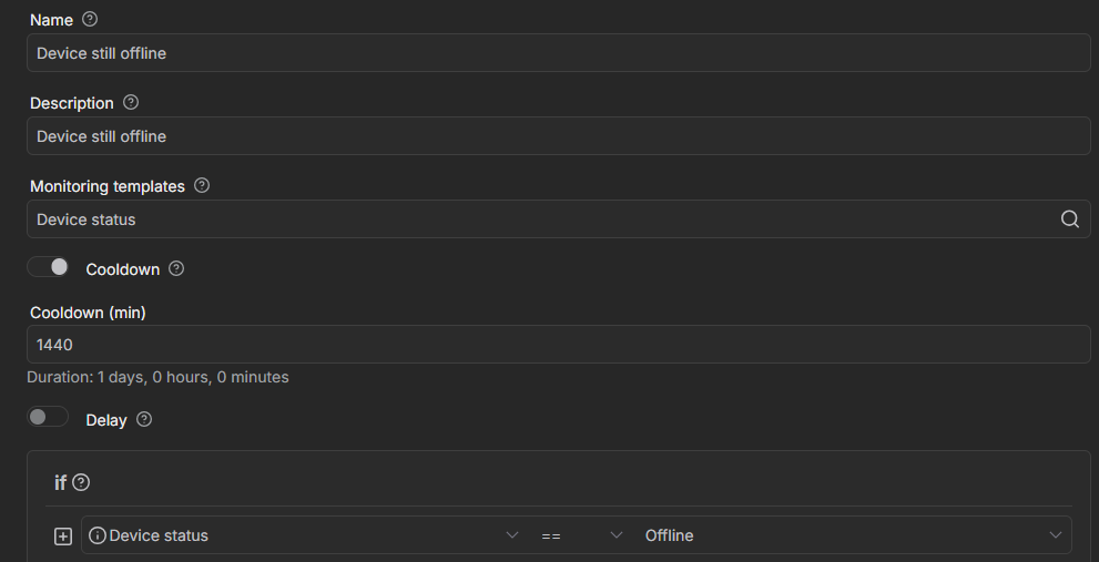

Hi MatasR,
Thanks, I have 2 automations and it works fine now. One detect the status change and one is active when a device is still offline.
