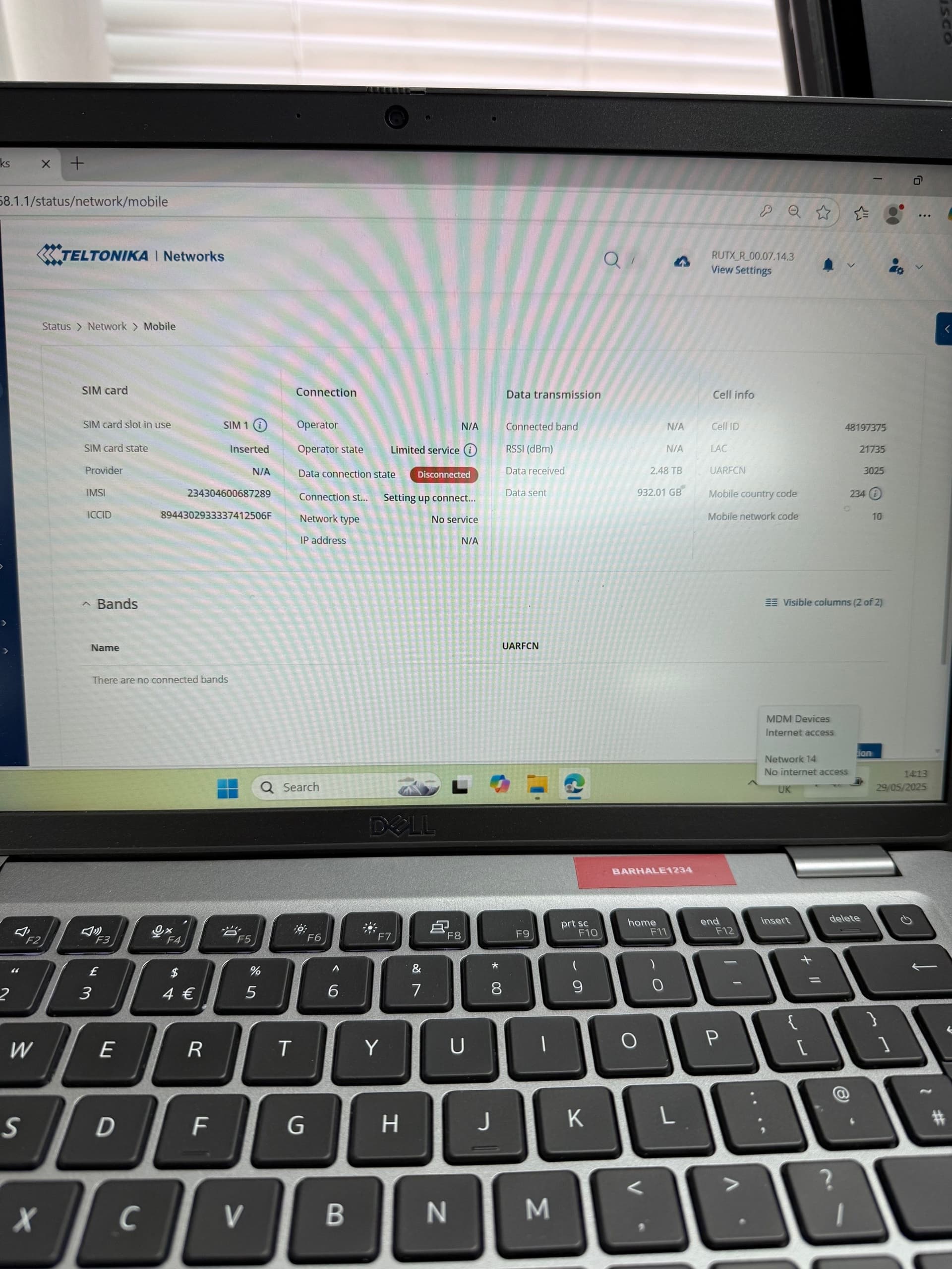

Could you also send us a screenshot from Status → Network → Mobile, while covering sensitive information. It will help us further troubleshoot the issue.

Yes, I have tried my own personal EE Sim card and it works fine in Sim 1 as soon as I put a company EE sim card in sim 1 it registers the sim has been inserted but shows as disconnected I have tried multiple EE APN settings and still nothing.
O2 & Vodafone sims all work fine in the same sim slot.
Aaron
