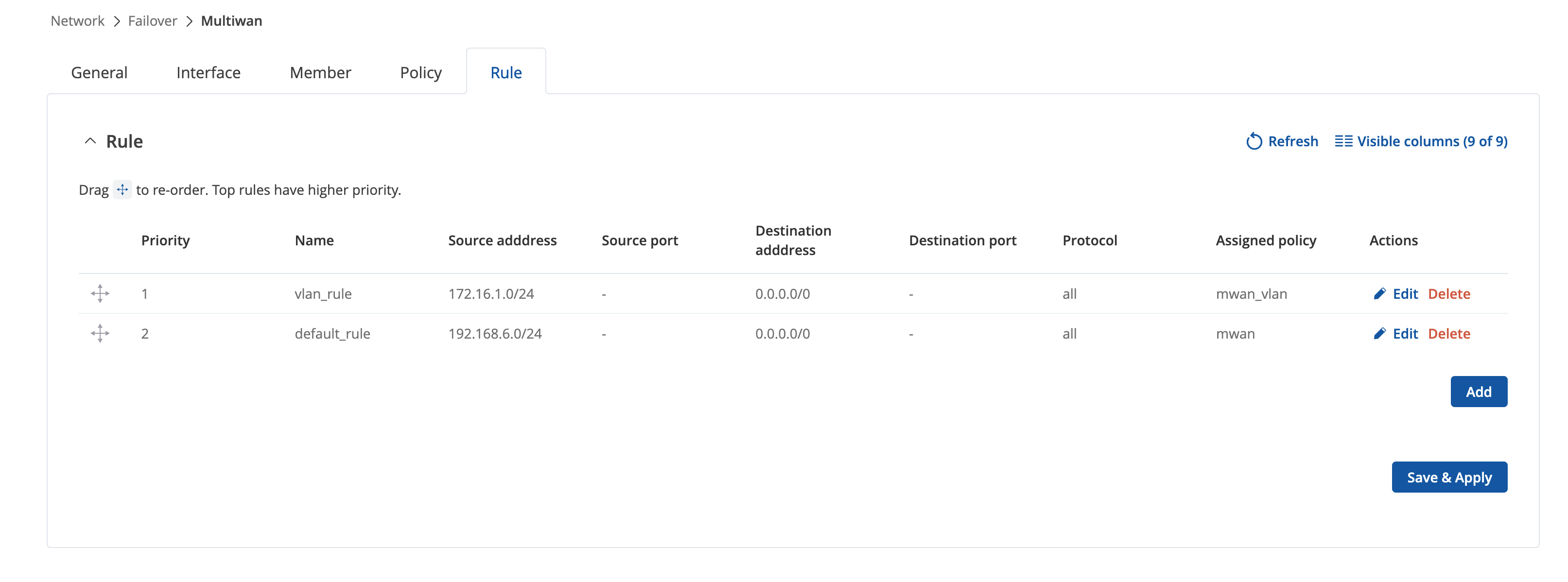

I have policy based routing enabled.. and my understanding is that default route for each internal network is defined here via the table ID (route table) depending on the source interface or traffic.. and the multiwan failover can be priorised; but doesn’t have an impact on PBR and route preference to the internet?
My rules are

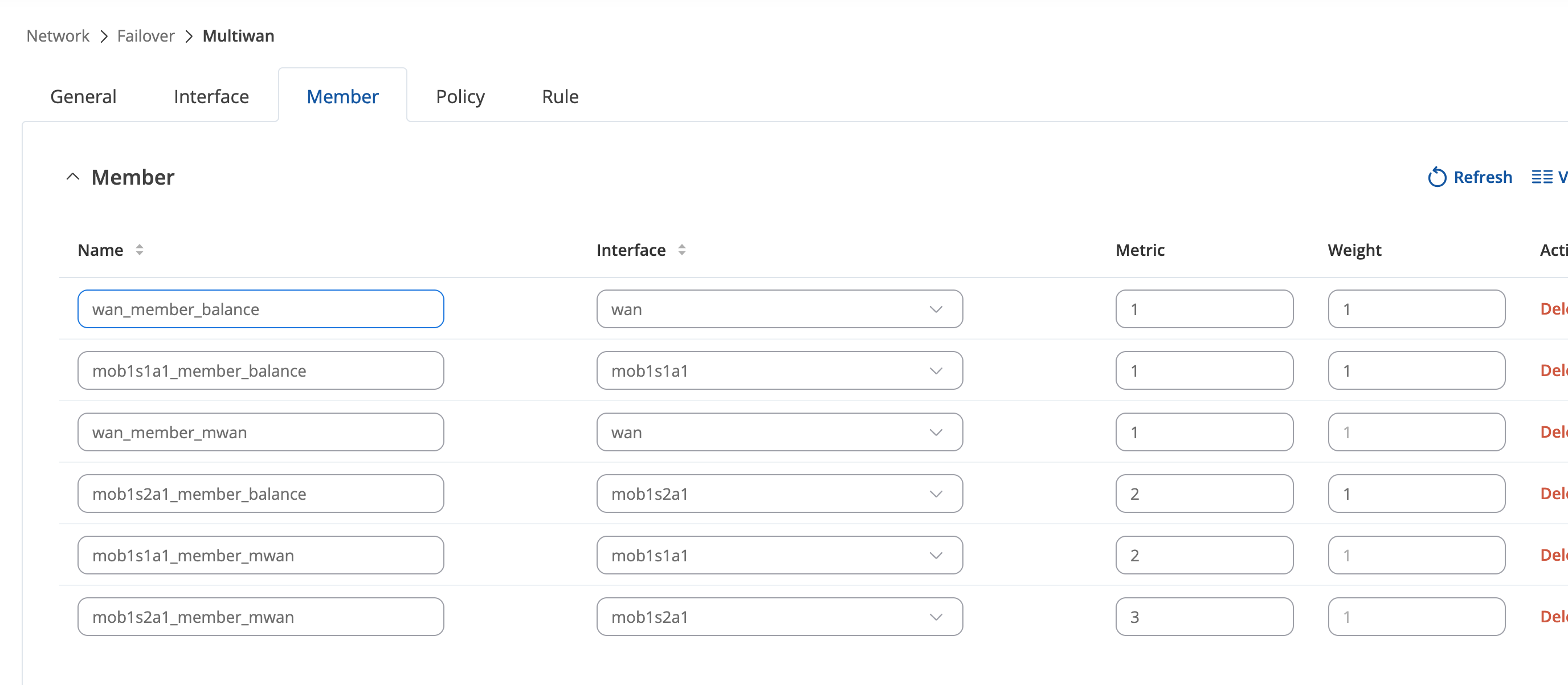

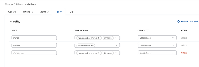

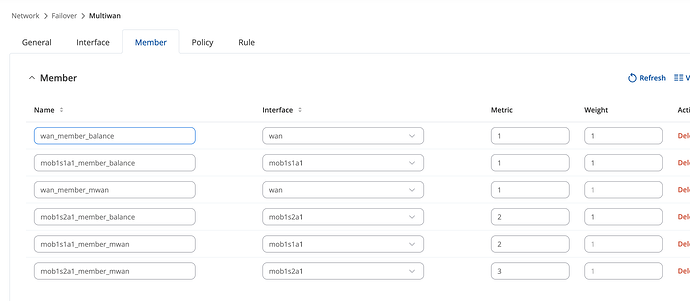

These are my failover multiwan settings.
You have a policy-based routing rule:
from all iif eth0.172 oif eth1 lookup 2
This means, that for any traffic coming in via eth0.172 and going out via eth1, use routing table 2.
Routing table 2 currently has the following default route:
default dev qmimux0 proto static scope link src 100.95.167.42 metric 2
This means that if there’s no more specific route, the traffic will go out through the mobile interface ( qmimux0 ), not through eth1, even though your rule mentions oif eth1.
This is because Linux routing decisions are made based on the routing table, and even though oif is specified in the rule, the actual next hop is still selected via the default route in the table.
So if there’s no route in table 2 that says “send this traffic out via eth1,” it won’t go out through eth1 - it’ll go through the default route to qmimux0.
To force traffic matching the rule to actually go out eth1, you need to add a default route via eth1 in routing table 2. And to make sure it’s preferred over the qmimux0 default route, give it a lower metric: for example, 1 in this case.
