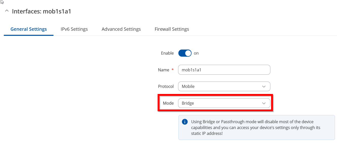

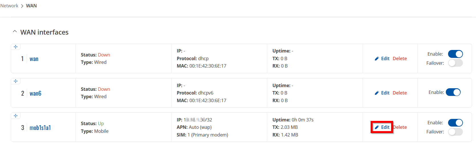

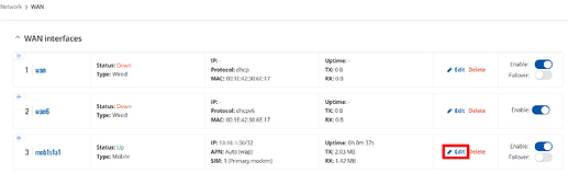

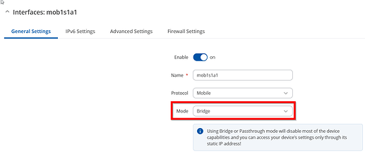

Setting the WAN interface to Bridge mode should be straightforward. Just follow these steps:
  1. Navigate to Network → WAN and click “edit” on your desired interface.
  2. Under mode, select “Bridge” and then click “Save & Apply”.
  1. After this configuration, you should no longer be able to reach the router via 192.168.1.1. Instead, your WAN address should be bridged to LAN ports.
