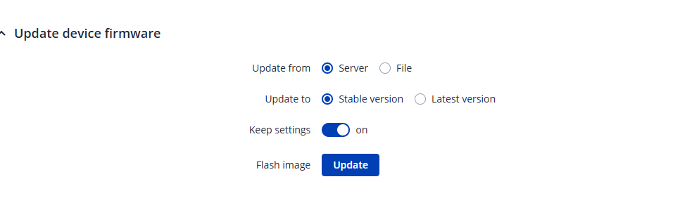

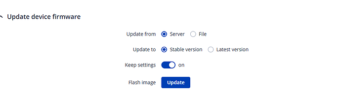

Had both options on for “Keep settings” for firmware and “Package restore” in the Package manager.

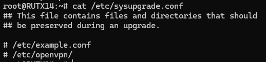

If you would like to retain custom scripts or files after a firmware update, you can edit the /etc/sysupgrade.conf file via the CLI. You can log in to the CLI by following the instructions provided here: Command Line Interfaces - Teltonika Networks Wiki
Once logged in, append the absolute paths of the files/directories you want to retain to sysupgrade.conf, as shown in the image below:
Please note that the sysupgrade.conf file is only taken into account when the firmware is upgraded with the Keep settings option enabled.
