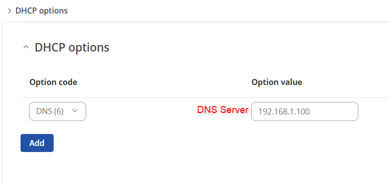

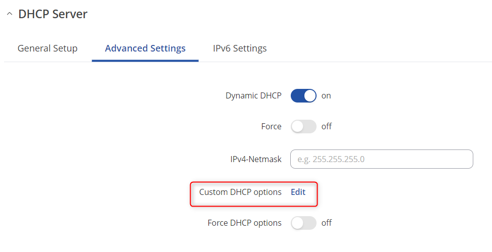

Since this option is not present in the WebUI, I would suggest using Option 6 in DNS settings on RUT to push your DNS server to the DHCP clients. This way, instead of sending DNS requests to RUT, which then forwards it to the server using its own IP, the DHCP clients would send DNS requests directly to your DNS server.
