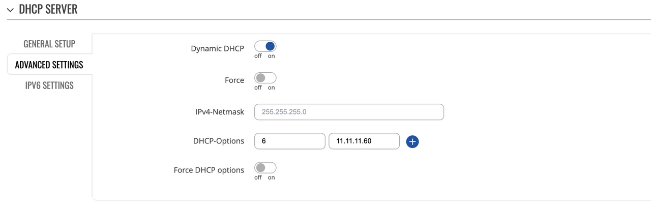

The DNS servers specified on the LAN interface are used to resolve hostnames. If you want to specifically push a DNS server to your DHCP clients, you can do so in the DHCP server settings. For this, go to Network → Interfaces → Edit LAN → DHCP server → Advanced options and use option ‘6’ to push your DNS server. For example:

Have you pushed the DNS server (PiHole) via DHCP option 6 as I have mentioned?
Does the PC connected to RUTX50 obtains the specified DNS server?

Yes, I pushed the Pi as the DNS server. These are the settings
Is your LAN on network 11.11.11.0/24?
Are you able to ping PiHole from the Router’s CLI?
